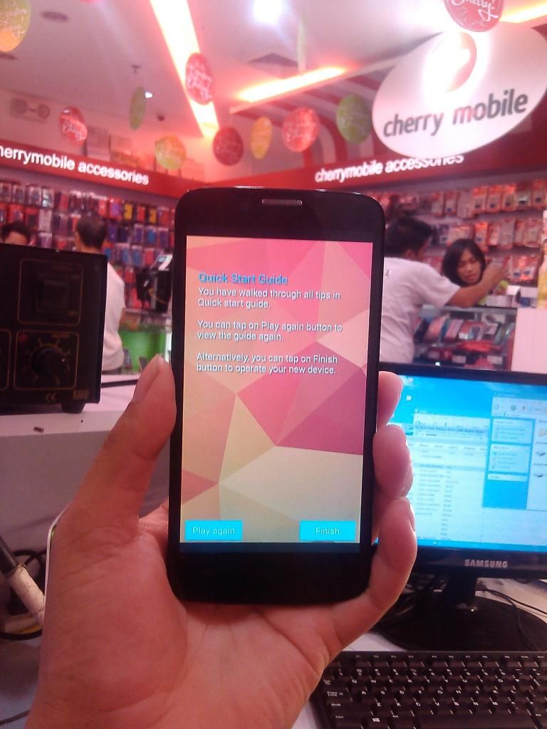

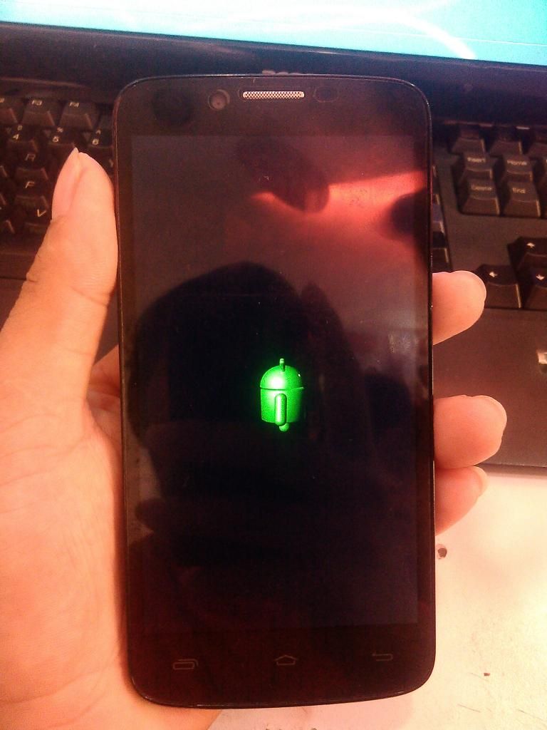

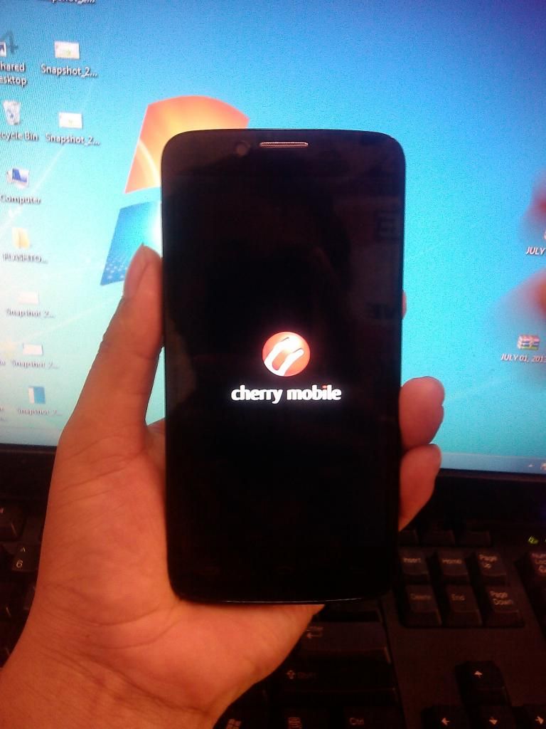

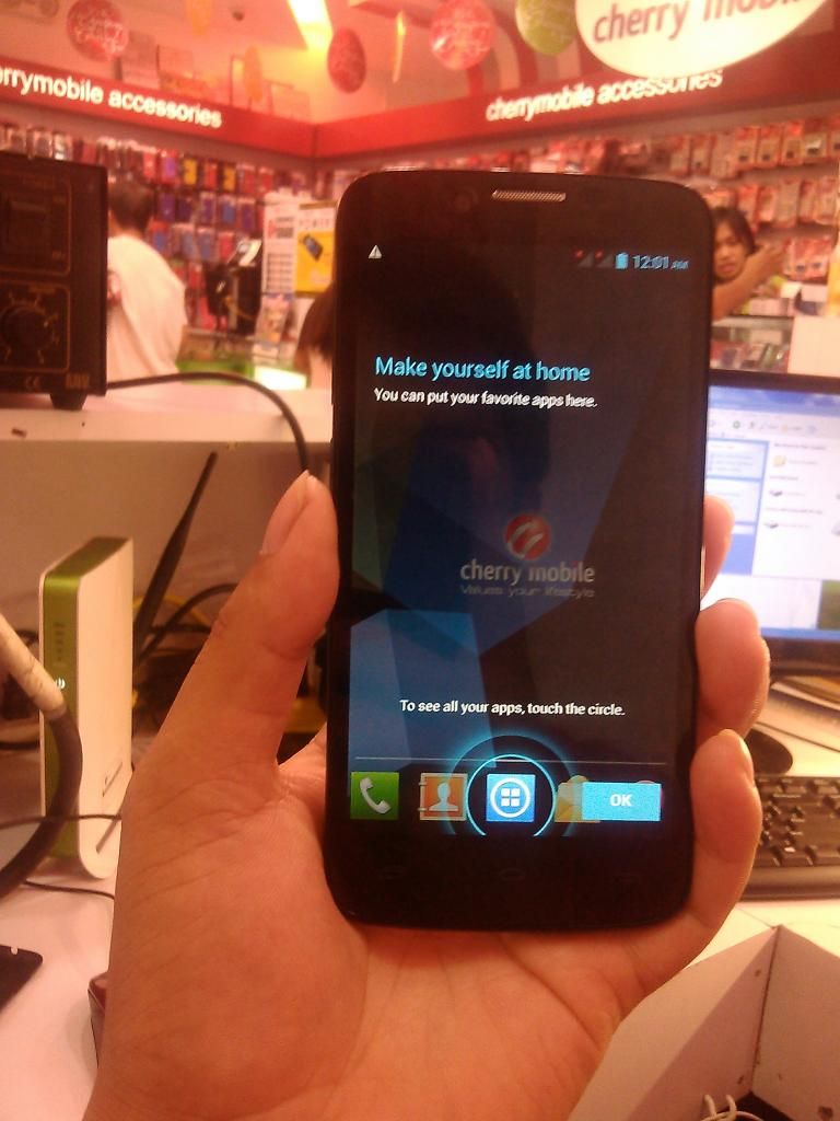

MAGANDANG ARAW SA INYONG LAHAT NAIS KO LANG ITO IBAHAGI SA KARAMIHAN... CHERRY MOBILE OMEGA HD 2.0 RESTART LOGO THEN OFF
SOLUTION FLASHING..

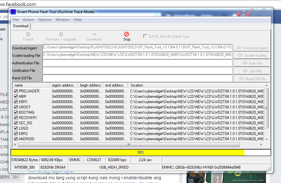

FLASHING THIS FILES : XOLO Q1000 STOCK ROM SUCCESS BUT NO DISPLAY BLUE SCREEN
TRY AGAIN
FLASHING THIS FILES : OMEGA HD 2.0 BUILD 49 STOCK ROM SUCCESS BUT BLUE SCREEN AGAIN
HANAP SA IBANG TAHANAN 5 FILES NA NAGAMIT PERO SAME PARIN BLUE SCREEN
POST NEED HELP SA WALL KO AYUN MAY NAG REPLAY TAGA SERVICE CENTER PA ;))

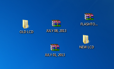

KAYA ALAM NA FACTORY FILES ANG NAIBIGAY

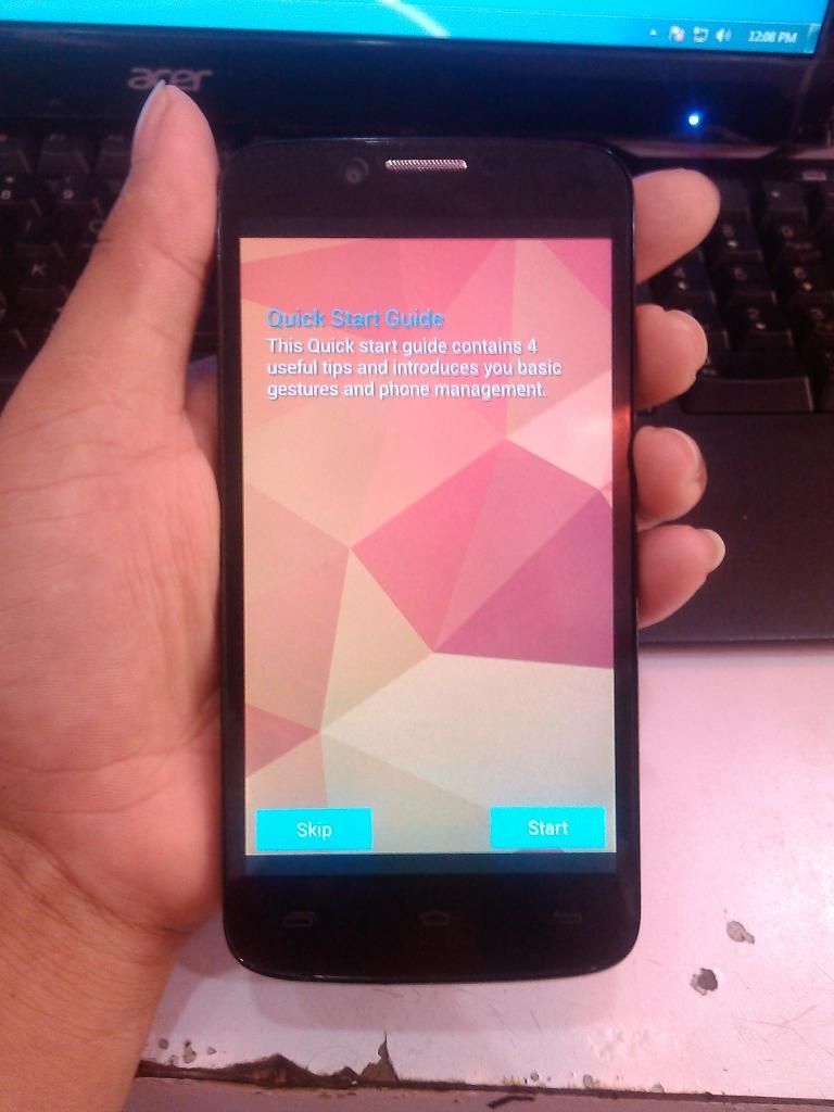

NEW LCD OLD LCD

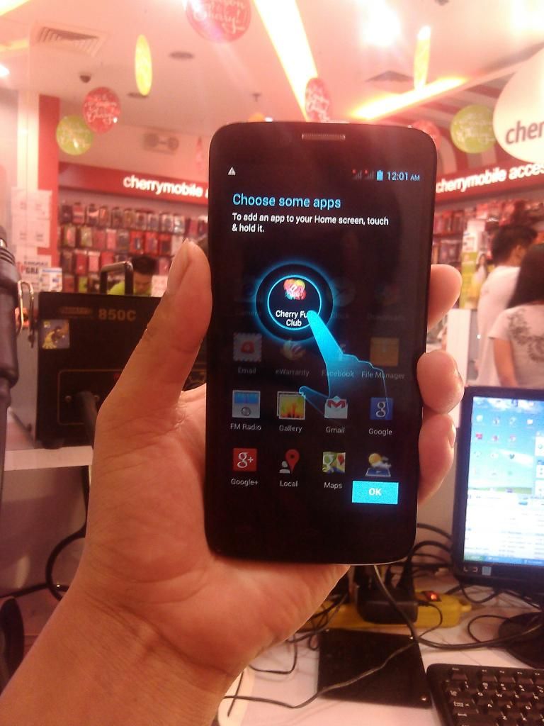

AYUN SUCCESS SYA SA OLD LCD :))
CHECK THIS SCREEN SHOT:
AYAN NATAPOS DIN SA WAKAS PROBLEM SOLVED

Nilabas na. . .hahah. . .congrats tol buti nasolusyonan mo, sa date ng LCD lang pala nagkatalo. Magandang reference ito, sa TAB touch ID tinitignan para accurate ang touch sa phone Factory Date ng LCD. Good Job tol!..=D>

any idea po baka mali lang flashing ko?? at anu pong ver. ng flashtool? -_-
