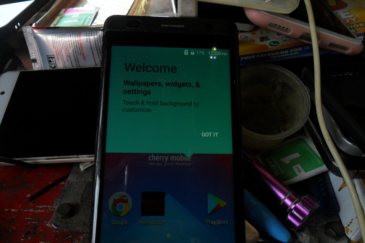

cherry mobile omega lite 3c hang on logo done

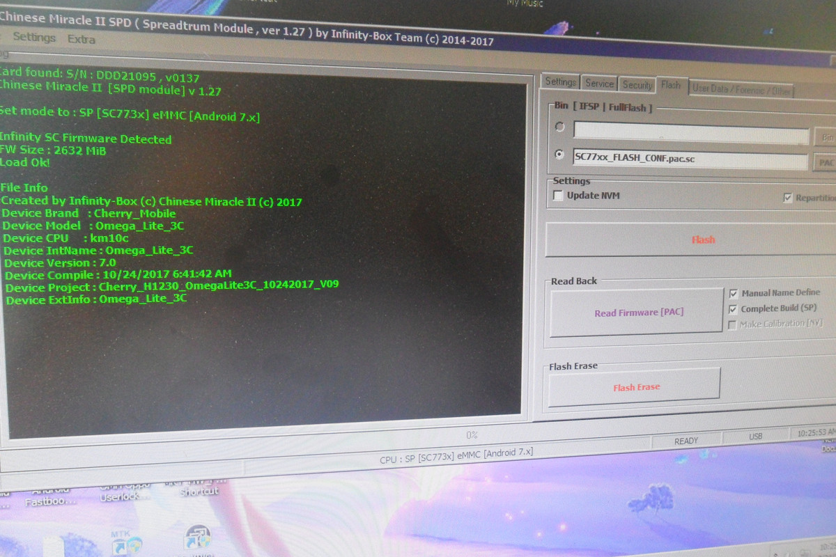

hanap tahanan FW maranmi yan

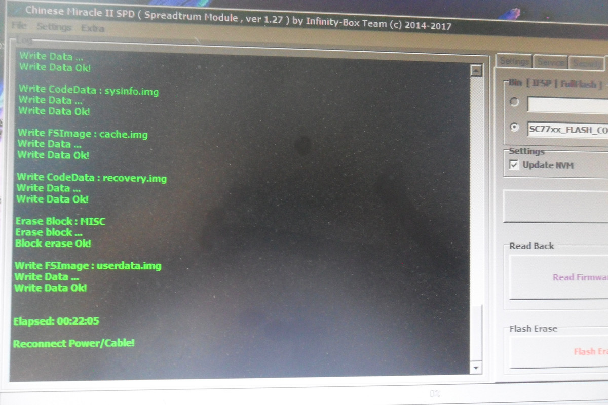

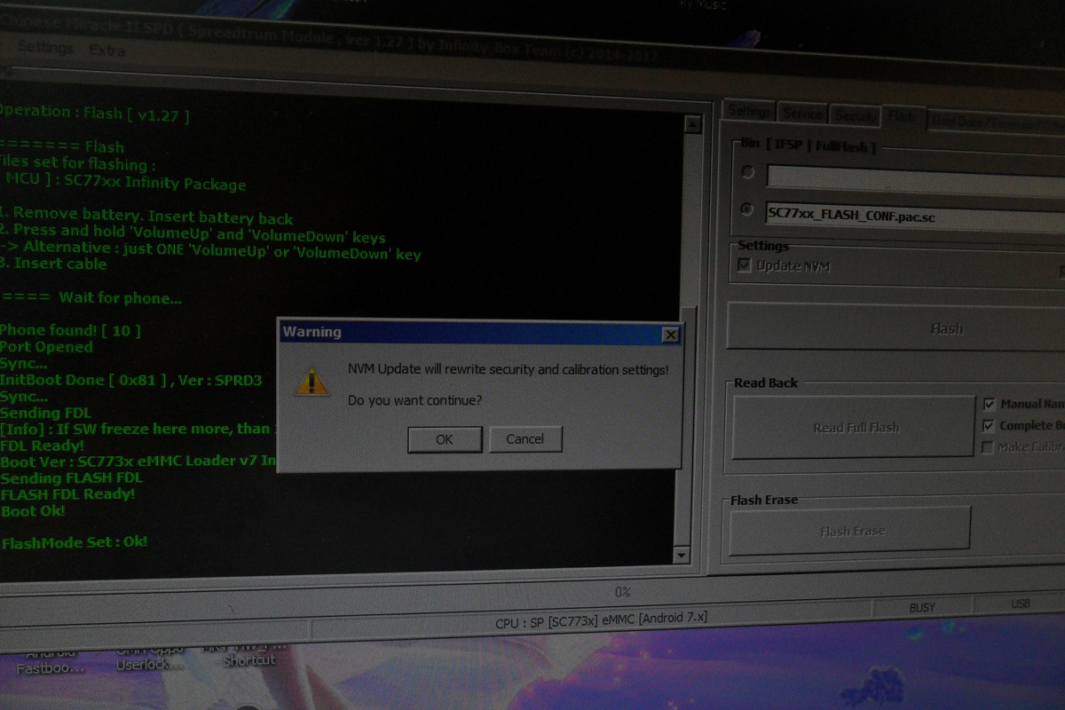

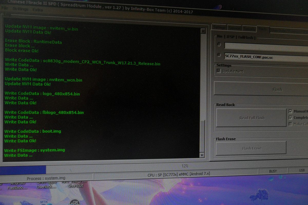

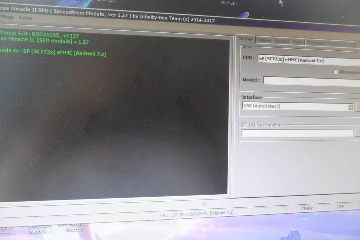

open cm2 spd v1.27
spd sc7xx-android 7.x
turn off cp

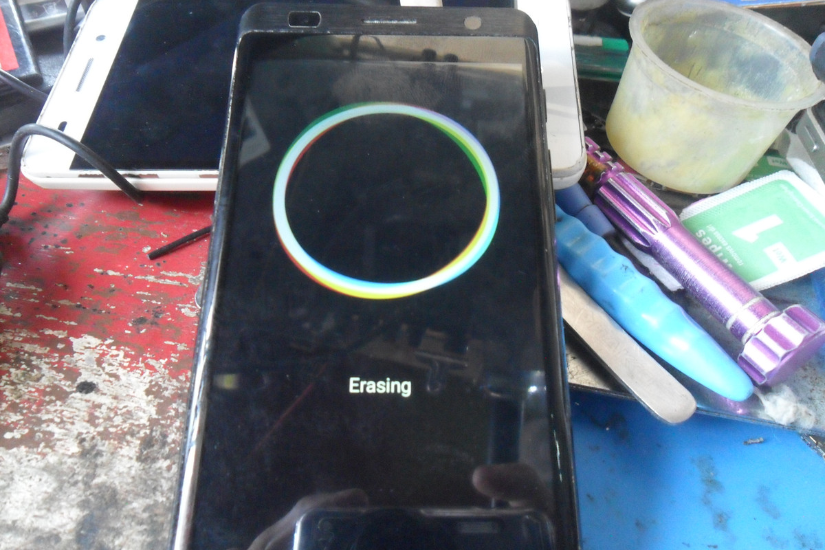

hold volume down
salpak usb cord
hit flash

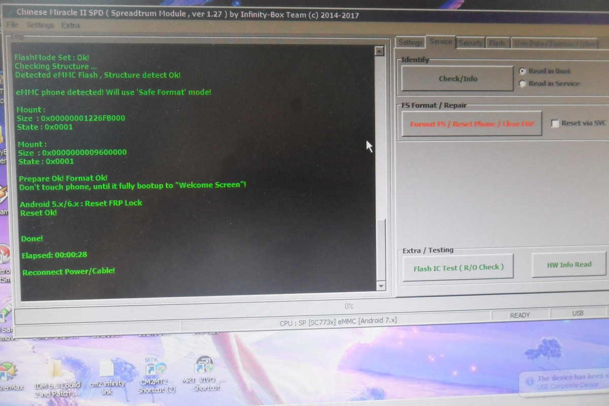

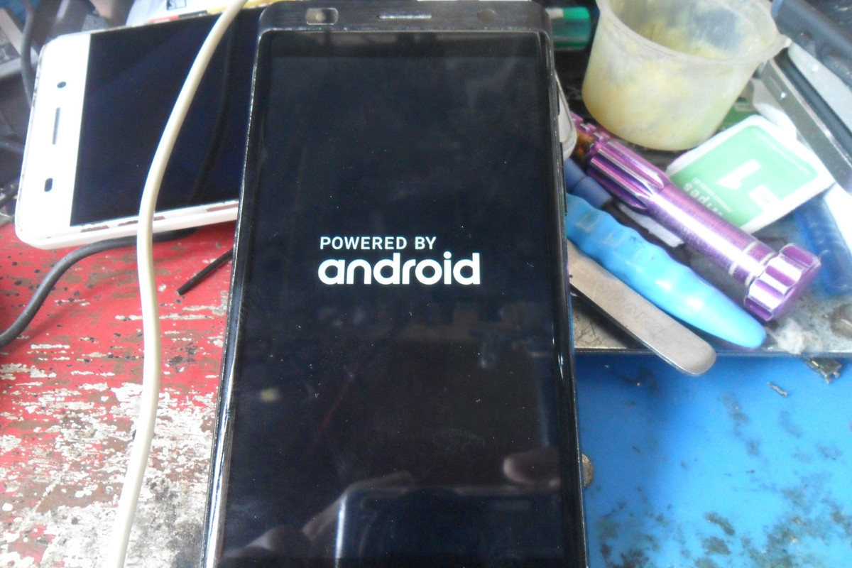

open cp
hang parin
kaya try ko
reset via cm2
image sharing sites

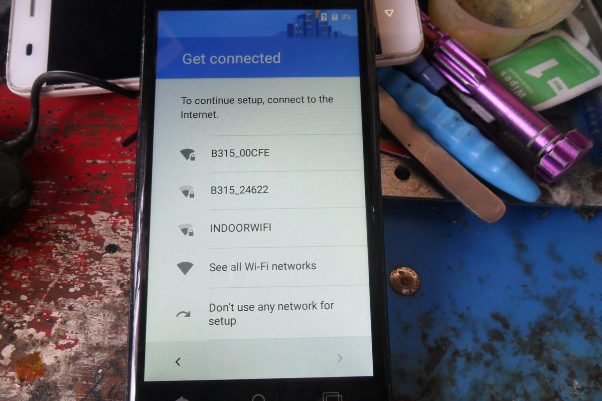

binggo

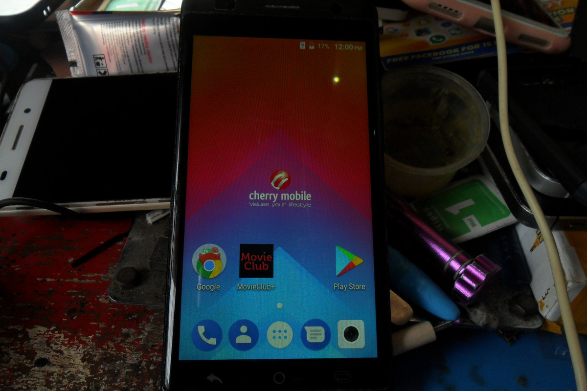

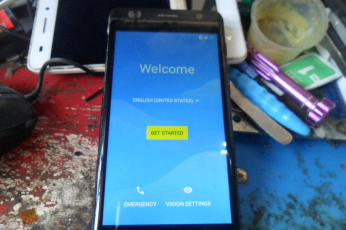

kaya try ko
reset via cm2
image sharing sites
binggo
