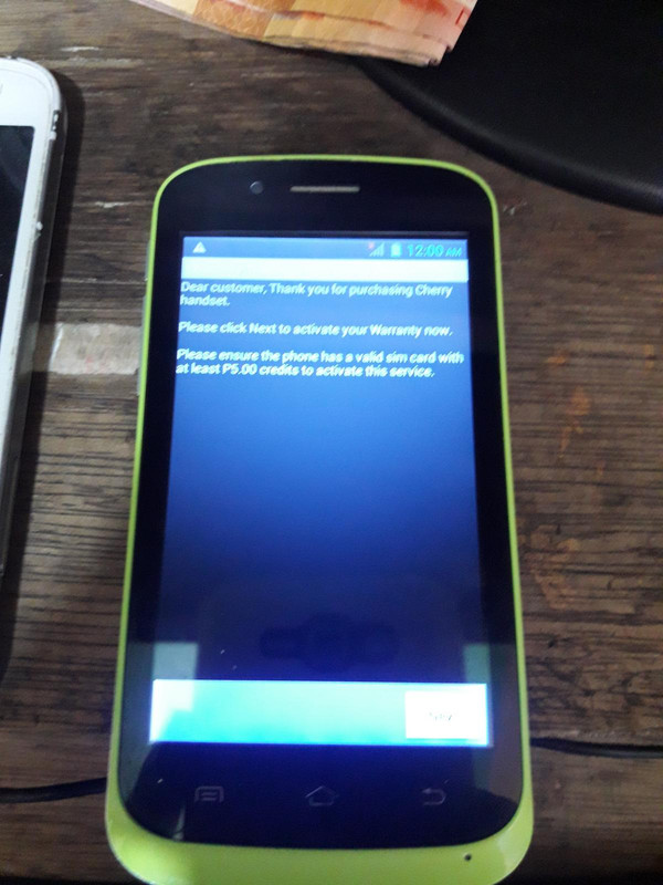

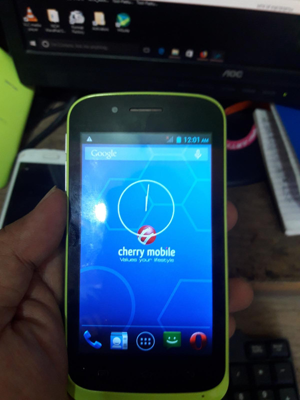

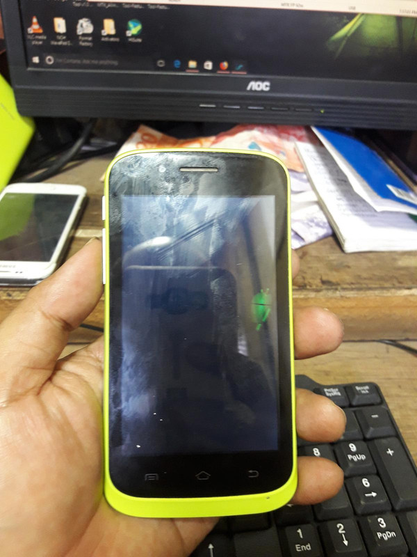

Cherry Mobile Quarts Hang Logo only Done By CM2 MTK
READ PHONE INFO THEN FORMAT FACTORY RESET

Operation : Format FileSystem [ v1.58 ]
Wait for phone...
Phone found! [ 5 ]
Sync...
Inital Boot Ok!
BB_CPU_PID : 6572
BB_CPU_NME : [MediaTek] MT6572_S00
BB_CPU_EXT : 0xCA01 , 0x8A00 , 0x0000
Processing BROM stage
Settings for BROM configured!
SecCfgVal : 0x00000000
BromVer : 0x00FF
BLVersion : 0x0001
Processing DA stage
DA Select done, will use MTK_AllInOne_DA_v3.3001.00.00
Sending and initialize DA ...
Running DA ver.4.2 on BBID : 0x88
NAND Flash : NOT INSTALLED
eMMC Flash : 1501004E3958524D4200E43CD081418F
Initialize Memory ...
DRAM already initialized by Preloader
DAgent sent , init HW now
eMMC FlashIC initialized
[eMMC] : FLASH_VEN : 0x15 , OEM : 0100
[eMMC] : FLASH_INF : [SAMSUNG] , BMRX9
[eMMC] : FLASH_CID : 1501004E3958524D4200E43CD081418F
[eMMC] : FLASH_BRT : 0x00200000 , 0x00200000 , 0x00020000
[eMMC] : FLASH_LEN : 0x0000000070000000
[eMMC] : FLASH_UCP : 1792 MiB [eMMC 2 GiB]
DEV RID : 0x5FEAFBA9E3D6F0ABED7B5D79F81268EC
INT RAM : 0x00020000
EXT RAM : 0x10000000 [256 MiB]
BOOT TYPE : EMMC_FLASH_BOOT
SOC VERIFY : C1
Boot Ok!
Clear USERDATA
Clear Ok!
Clear CACHE
Clear Ok!
Done!
Elapsed: 00:00:20
Reconnect Power/Cable!
