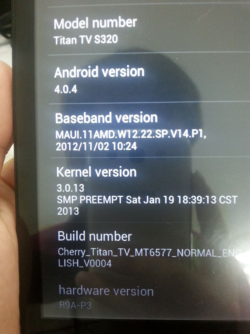

Model: Titan TV
Chep: MT6577
Problem: Hang logo & rebbot
Sulotion:

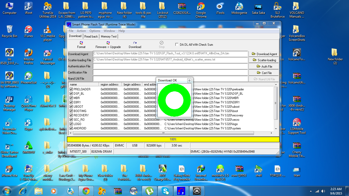

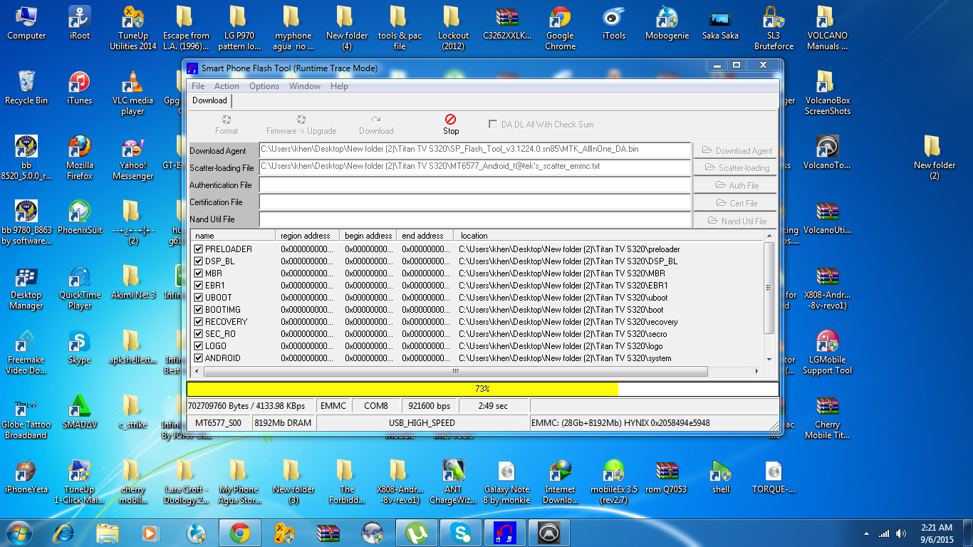

Flash with freesoft SPFlasHtol & tested rom
Procedure to flash
Open SPFlashtool
click scatter file MT6577
Hold vulume up or down
sabay saksak ang micro usb
Click download, hintayin bago ma tapos ang flash
ScreenShot.

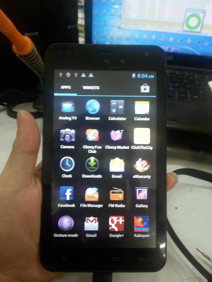

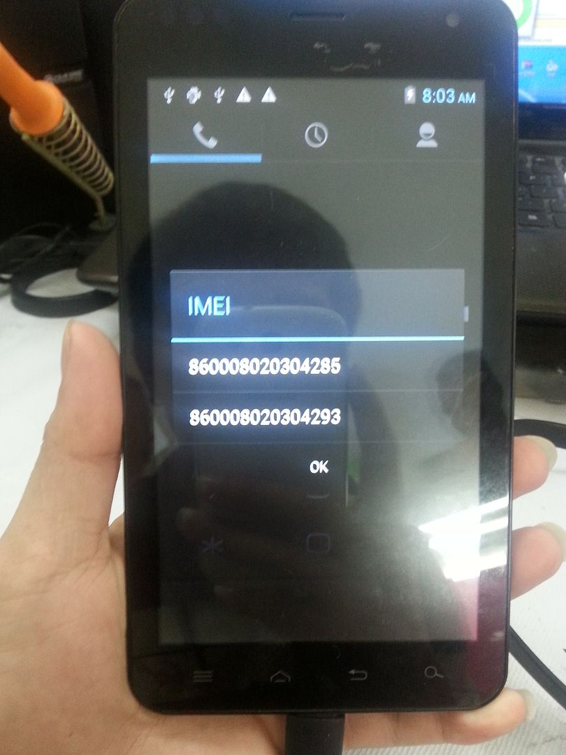

Solved!!!
