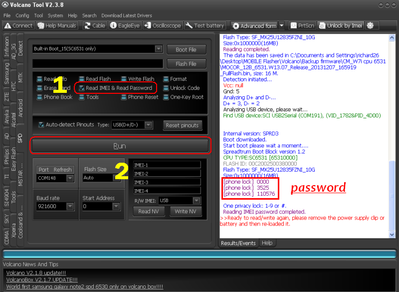

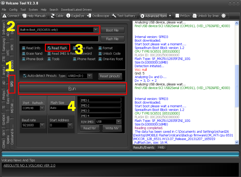

*Connect Phone via volcano usb jig P-05B
*Open Volcano Tool
*Click SPD tab
*Select Built-in Boot_15 (SC6531 only)
*Check Read Flash
*Click Run
*Check Read IMEI & Read Password
*Click Run
*DONE...

Connect Phone, open Volcano Tool and make Back-up first
Check Read IMEI & Read Password then Click Run

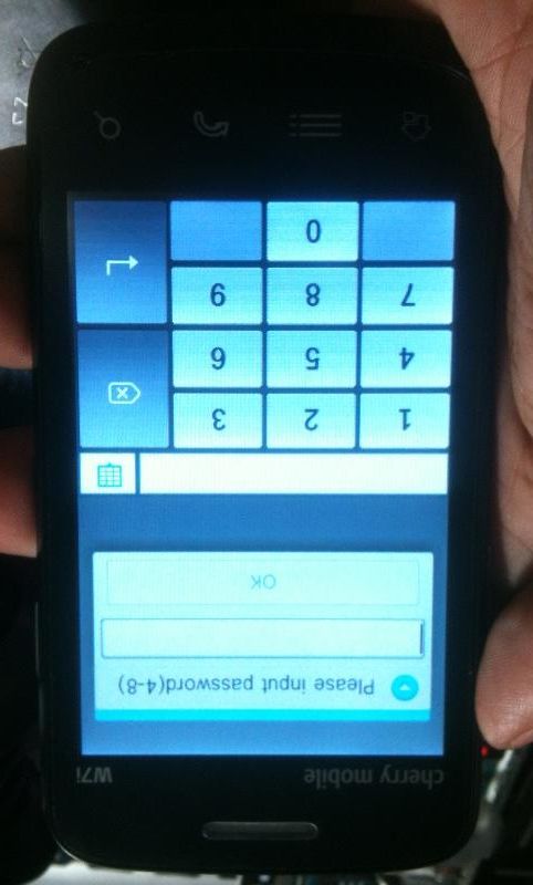

Enter Password read by Volcano

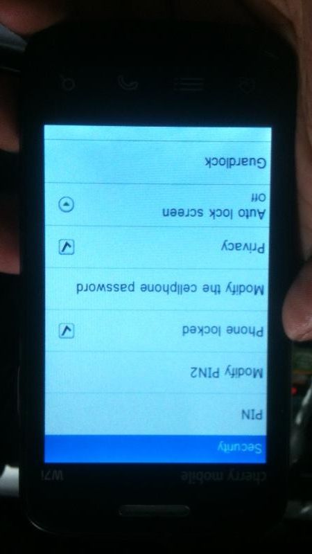

Go to Settings remove Phone Locked & Privacy and your done...
