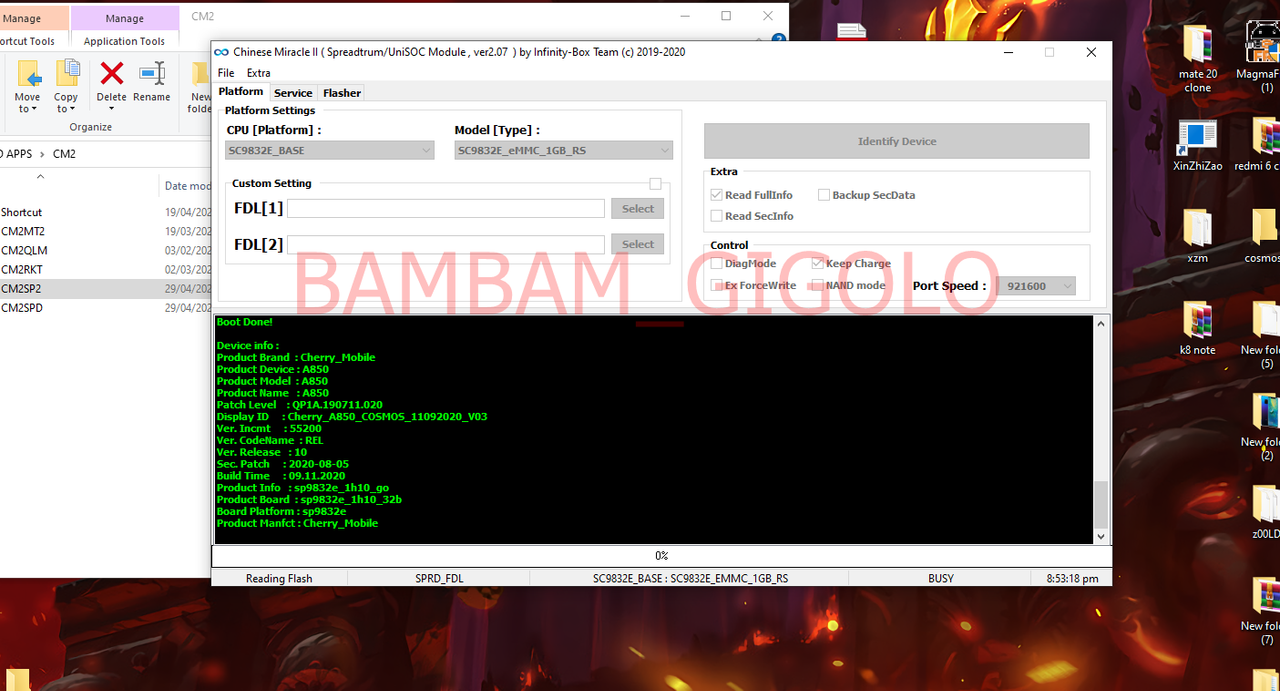

CHERRY TABLET A850 SC9832E FRESAH BACK UP
steps;
1. OPEN CM2SPD2 CHOOSE SC9832E THEN IDENTIFY FIRST
2. BOOT KEY IS VOL-
3.AFTER IDENTIFYING SELECT FLASH THEN READ FLASH
4.SELECT WHERE YOU WANT TO SAVE AND WAIT TIL FINISHED..
Device Connected!
BootVersion : SPRD3
Boot : INF : 0_SC9832E_BASE : SC9832E_eMMC_1GB_RS
Sending Init Boot ...
Boot sent!
Kick FDL ...
BootVersion : Spreadtrum Boot Block version 1.1
Protocol setup ...
Port speed : 921600
Sending Flash Boot ...
Boot sent!
Kick FLASH FDL ...
FDL : 0x0002
FDL : Control transfered!
Boot Done!
Device info :
Product Brand : Cherry_Mobile
Product Device : A850
Product Model : A850
Product Name : A850
Patch Level : QP1A.190711.020
Display ID : Cherry_A850_COSMOS_11092020_V03
Ver. Incmt : 55200
Ver. CodeName : REL
Ver. Release : 10
Sec. Patch : 2020-08-05
Build Time : 09.11.2020
Product Info : sp9832e_1h10_go
Product Board : sp9832e_1h10_32b
Board Platform : sp9832e
Product Manfct : Cherry_Mobile
AndroidVer : 10
VlnrLevel : 0x02
SP9832E__10__Cherry_A850_COSMOS_11092020_V03__QP1A.190711.020__sp9832e_1h10_go
Read : u-boot.bin
Read : sml.bin
Read : tos.bin
Read : vbmeta.img
Read : vbmeta_system.img
Read : vbmeta_vendor.img
Read : dtbo.img
Read : ldsp_l.bin
Read : gdsp_l.bin
Read : modem_l.bin
Read : deltanv_l.bin
Read : nvitem_l.bin
Read : modem_wcn.img
Read : gnssmodem.bin
Read : gnssbdmodem.bin
Read : pm_sys.bin
Read : boot.img
Read : recovery.img
Make : persist.img
Read : boot_logo.bmp
Read : fastboot_logo.bmp
Make : userdata.img
Make : cache.img
Read : prodnv.img
ExtSparse : Compression ratio : 29%
Read : socko.img
ExtSparse : Compression ratio : 34%
Read : odmko.img
ExtSparse : Compression ratio : 2%
Read : phase.cfg
Read : super.img
Read : u-boot-spl.bin
Firmware size : 0x8162562C ( 2.02 GiB )
Android Info saved : _Android_info.txt

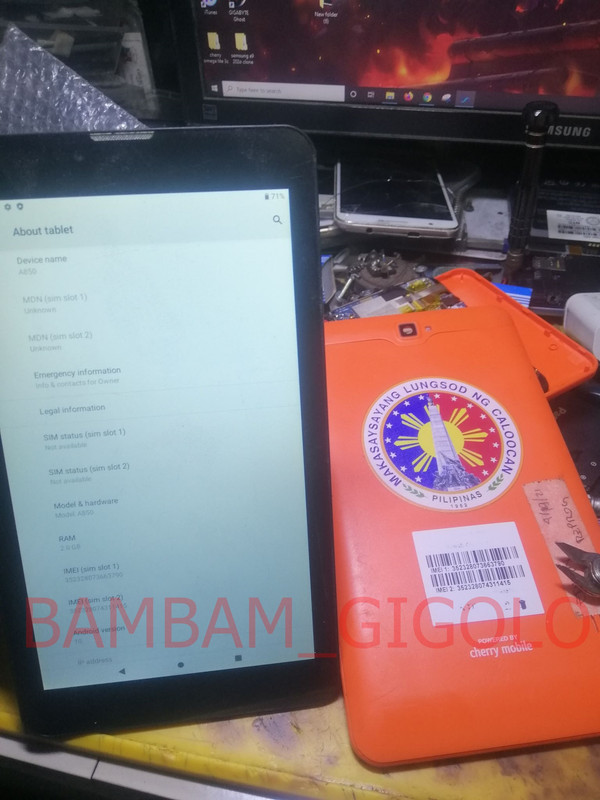

reflash your back up.. then reflash again with only system, cache and userdata. if not done, try other back ups sa haus natin.. laruin mo lng sir mga img. file paisa isa mo ireflash.. if not maybe hw prob..all the luck
baka may tama ang EMMC bro.. pero salamat sa firmware magagamit ko ito sa ibang customer ko
