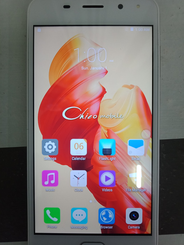

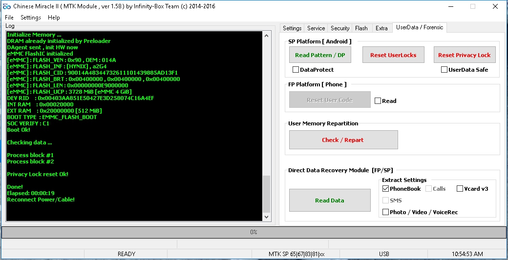

andreivi Registered Joined Jul 30, 2014 Messages 1,986 Reaction score 271 Points 381 Location Sison, Pangasinan/ Rosario, La Union Nov 25, 2019 #1 share po mga boss Chico mobile Ojos cielo Privacy Protection Password Done Sa CM2 Open CM2MTK select correct platform Click User data Forensic Turn off phone click reset privacy lock connect phone to usb antayin matapos done
