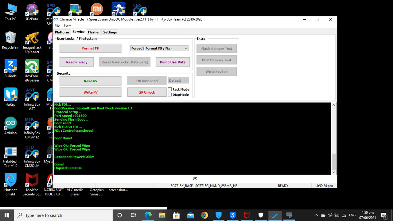

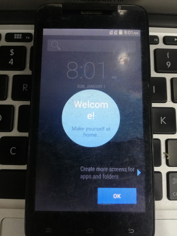

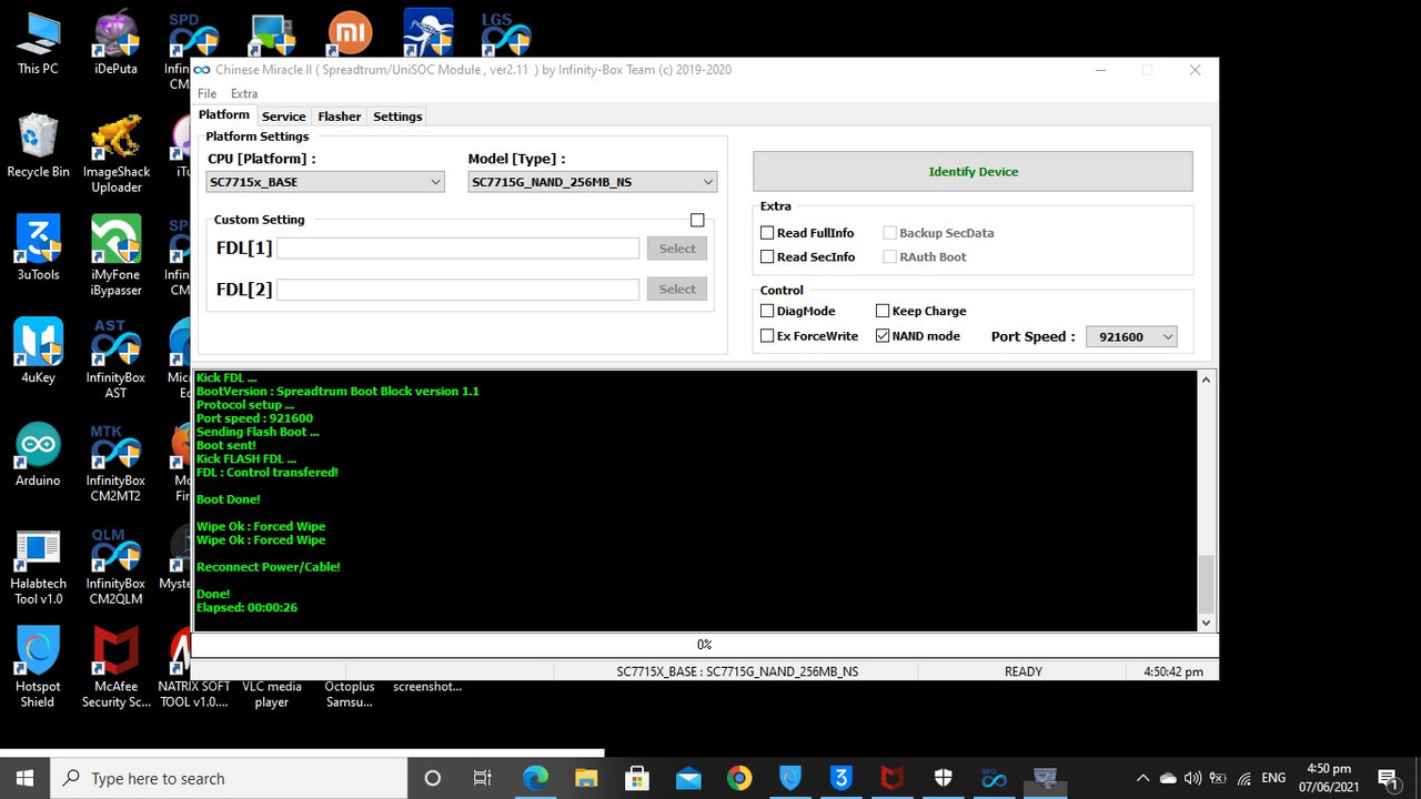

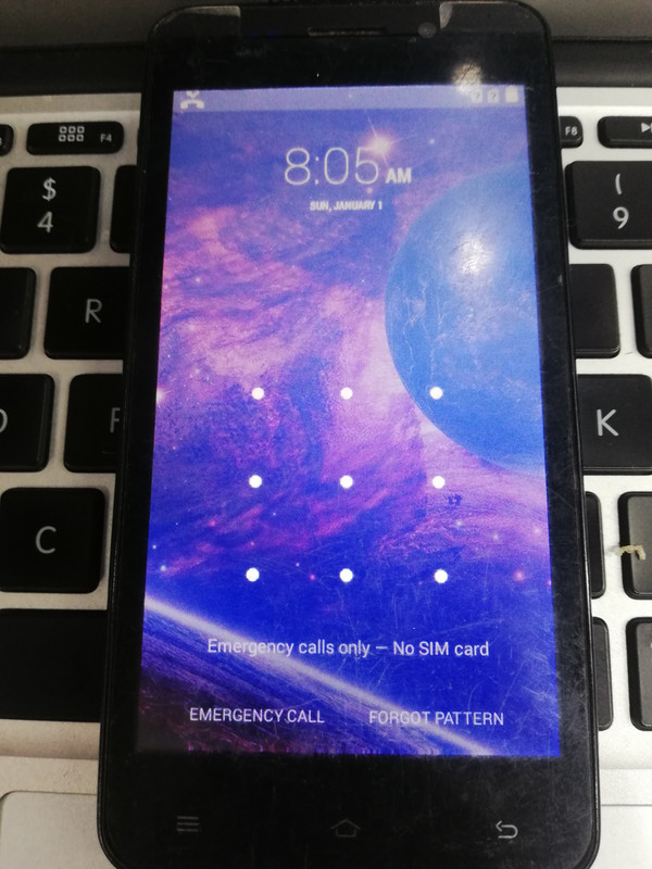

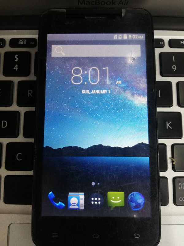

J joystikz Registered Joined Dec 4, 2014 Messages 155 Reaction score 148 Points 1 Location Davao City Jun 7, 2021 #1 HISTORY: Nakalimutan ang pattern. Hindi rin ma hard reset. ACTION TAKEN: OPEN CM2SP2 SPD CPU Platform: select SC7715X_BASE MODEL TYPE: SC7715G_NAND_256MB_NS Go to SERVICE Select FORCED FORMAT FS/FIX Click FORMAT FS Turn off phone Hold volume up Insert usb cable done.
jhundragon Registered Joined Nov 23, 2016 Messages 187 Reaction score 100 Points 151 Location San juan Avenue North Centro Sipocot Camarines Sur Sep 27, 2021 #2 tested po boss salamat
