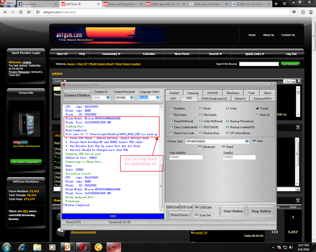

share kolang TMPA problem ng ckk leo wla po cya pac file ky paring google kya back up ko ky MC crack
pgkatapos format agad :D
succes format wla din ako actual n phone wla parin mgamit png pic :D
pro 10000% succes
bin file uploading verry soon sa mga nangangailangan commnt lng po :D
thnk you masaganang bwenamano

pano po procedure ng pag flash mga sir
ito procedure amu..
open piranha crack
select SPD tab
then tick write
in boot option select 6820/8810
load mo c bin file natin
power off c phone
after power off
hold vulume up & vulume down
at sak2x phone sa pC via USb automatic po mg pa flash yn hntayin nlng hanggang matapos,,,,
slamt,, :D
