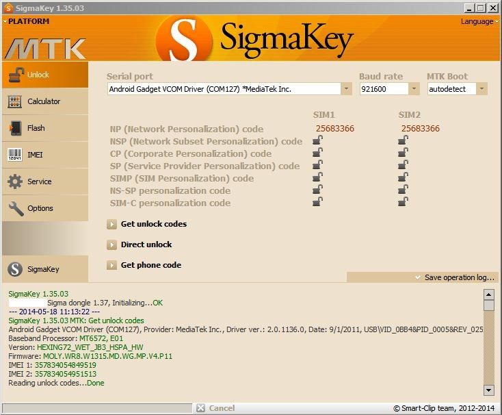

cloudfone excite 400dx

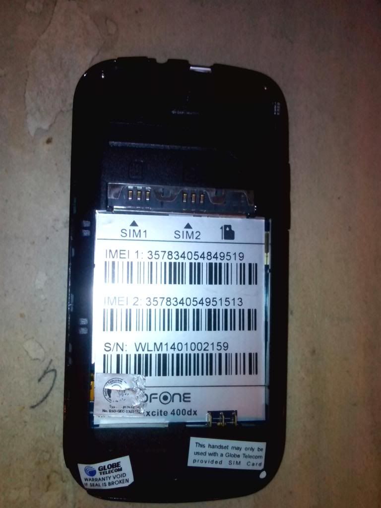

Lock sa GLOBE at unsupported to unlock
Pero Sinubukan ko parin baka sakali matsambahan
Kapa-kapa mode..
.. Volume-Up plus salpak USB
Ooops nag-connect agad.. click read code muna para wala problema..
BOOOOOOOOMMM na read code naman..

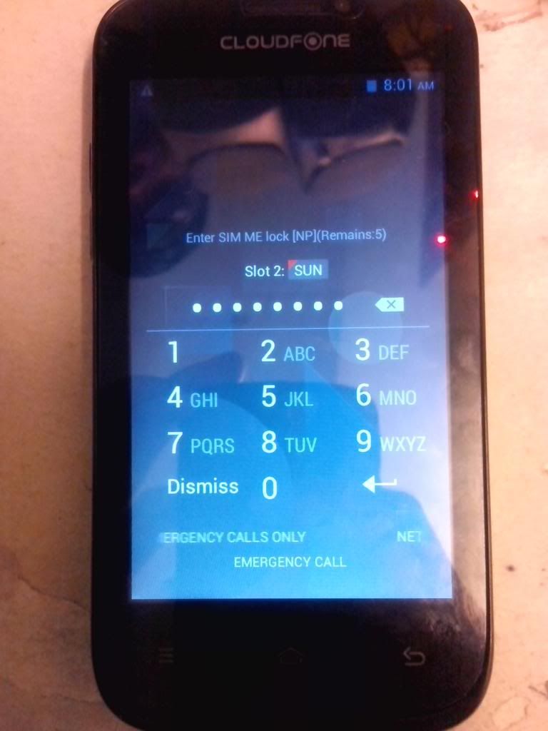

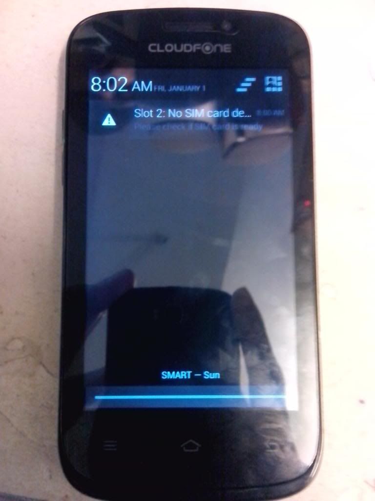

open phone w/other sim at ilagay ang code..

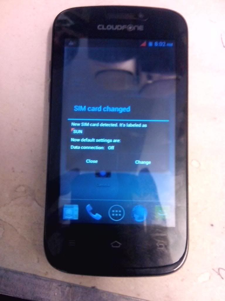

BOOOOOM na unlocked din
sabi ng customer subukan daw lagyan ng sim yung SIM 2
PROBLEM insert code nanaman

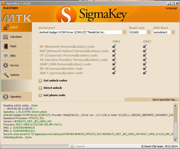

format the phone then lagay sim result same parin nag-lalock parin.. last move Direct Unlock = Done
