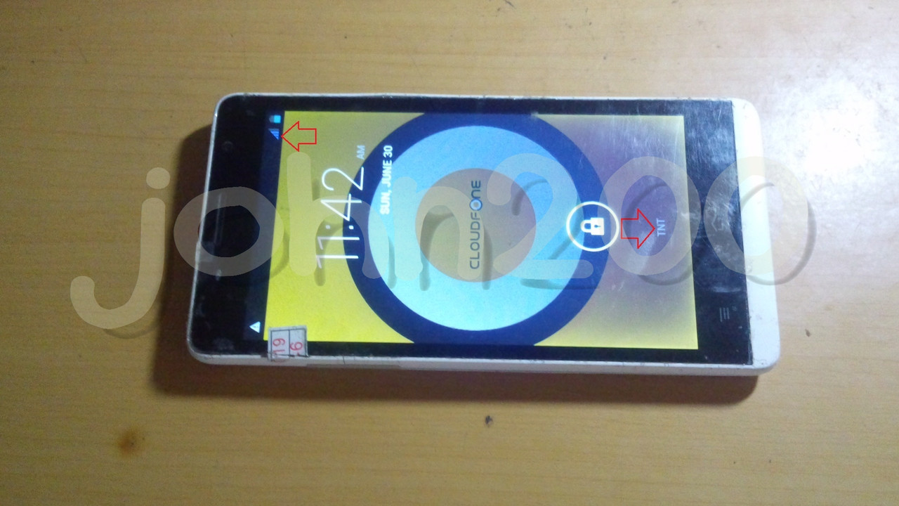

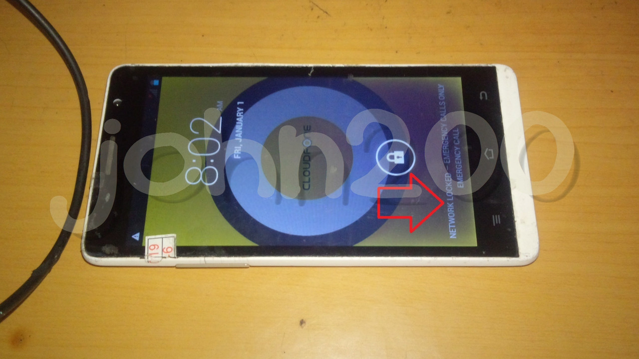

Problem :
Globe Lock

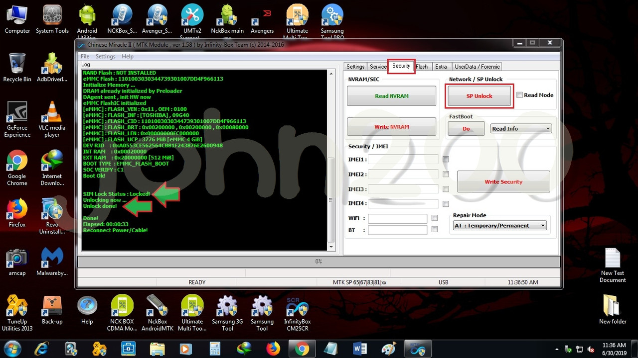

Solution :
Network Unlock
Tools :
CM2 Dongle
CA-101 Micro USB Cable
Procedures with Screenshots :
Run InfinityBox CM2MTK GUI
Click Security Tab
Click SP Unlock Button
Power Off Device
Insert CA-101 Micro USB Cable
Wait till Unlocking done
Result :
Done...
