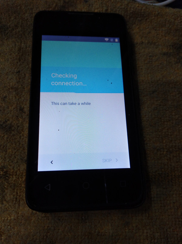

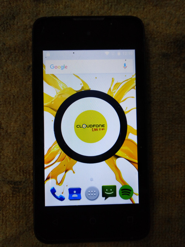

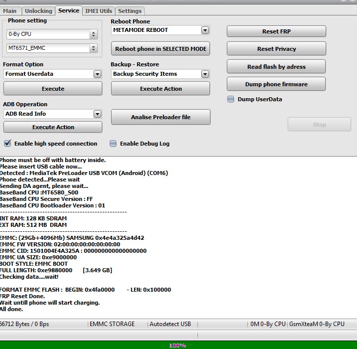

jael1968 Premium Account Joined May 18, 2016 Messages 230 Reaction score 28 Points 1 Location Cebu City Nov 12, 2018 #1 Cloudfone Ice Plus 2 FRP Done by NCK Crack.. Procedure: - Open NCK Crack - Click Boot Info - Go to Service - Click Reset FRP WAIT UNTIL ITS DONE.. DONE.
