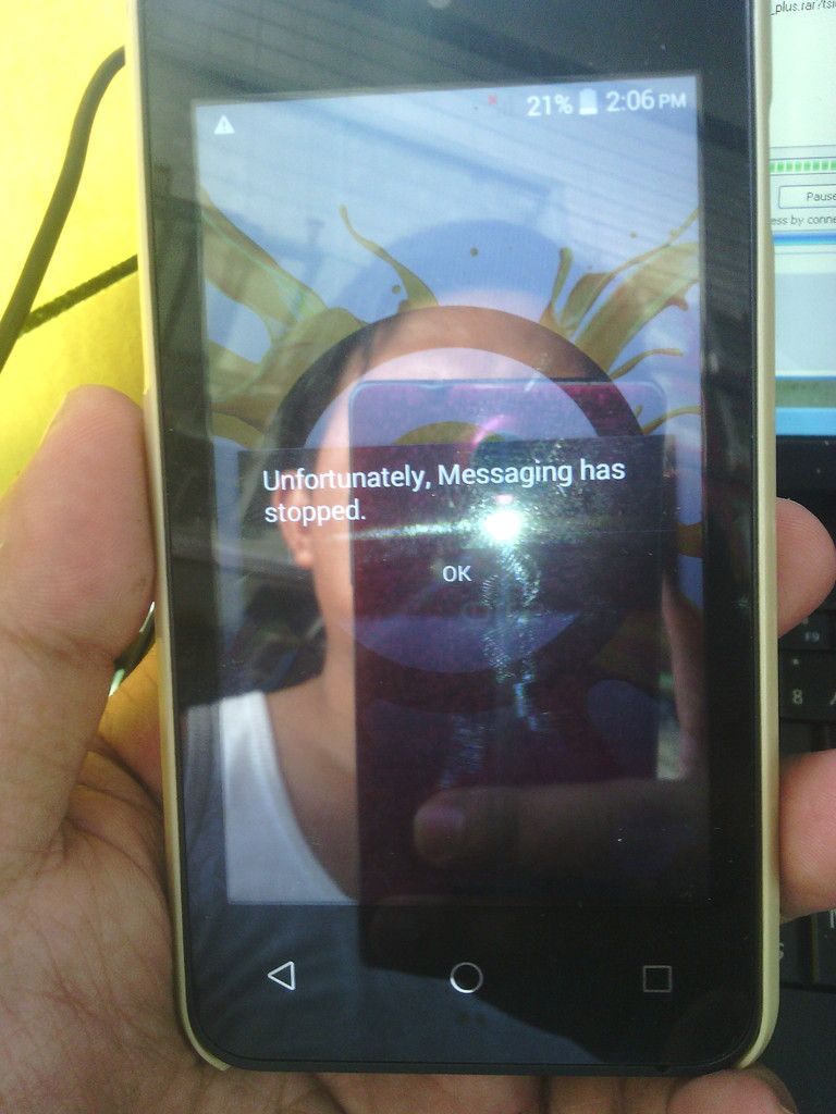

PROBLEM
unfortunately messaging has stoppped
try ko hard reset pero ganun parin ayaw talaga

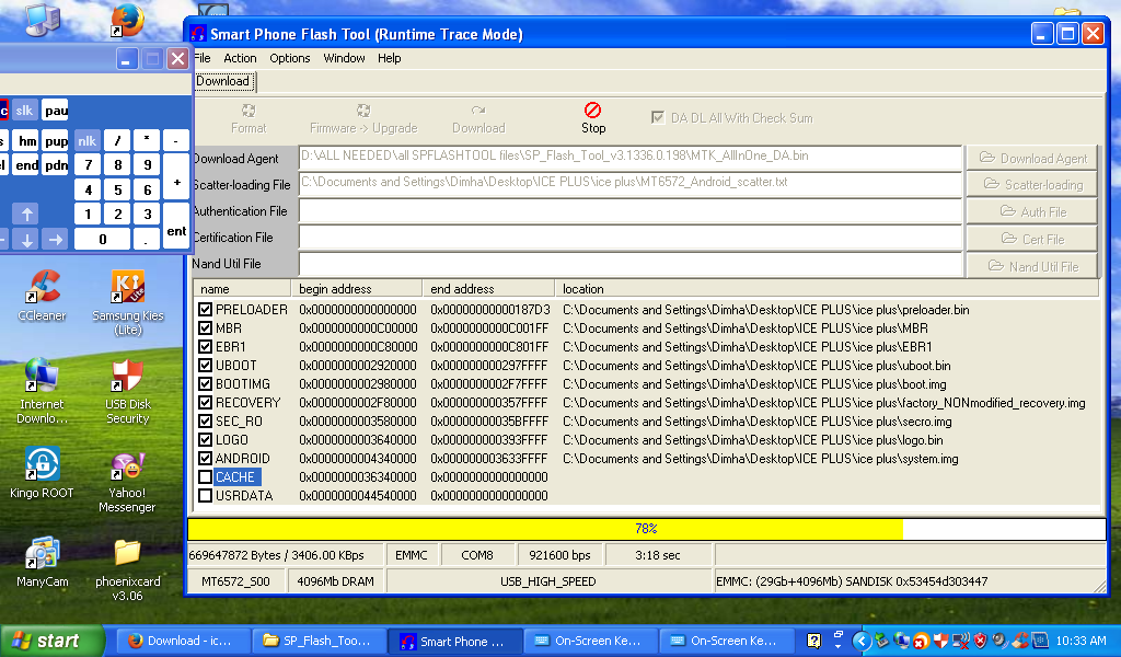

kaya proceed to flashing na ako
Procedure
1.Open sp flashtool and load firmware
2.Select download only and press volume down para madetect ng pc.

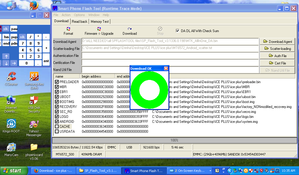

3.Wait until finish ok!
flashing download only
process

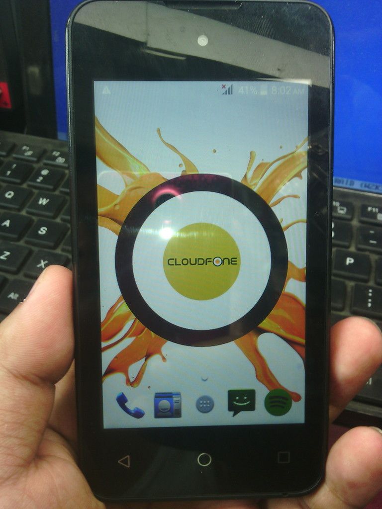

done na poh

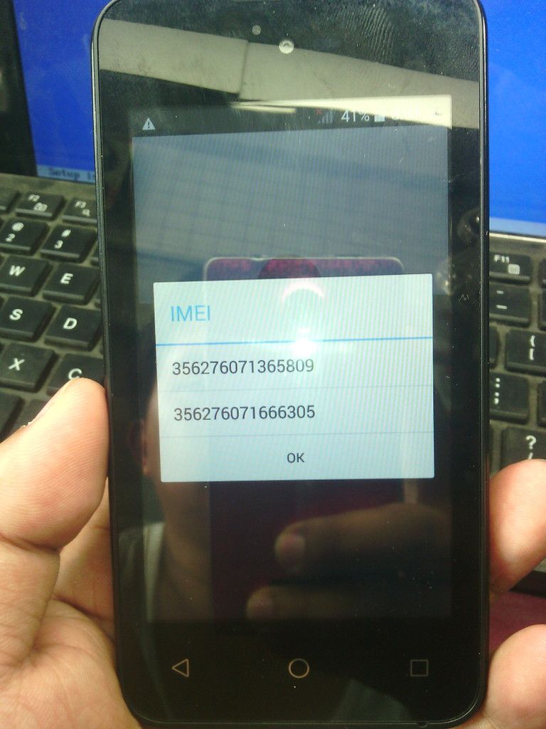

at ito poh ang resulta ayos na
pati IMEI ok na rin
