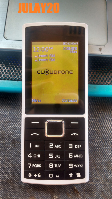

post ko lang mga boss wala pa ditoyan
blue screen lang po sya pero pag on mo ng unit lomalabas logo tapos blue screen na

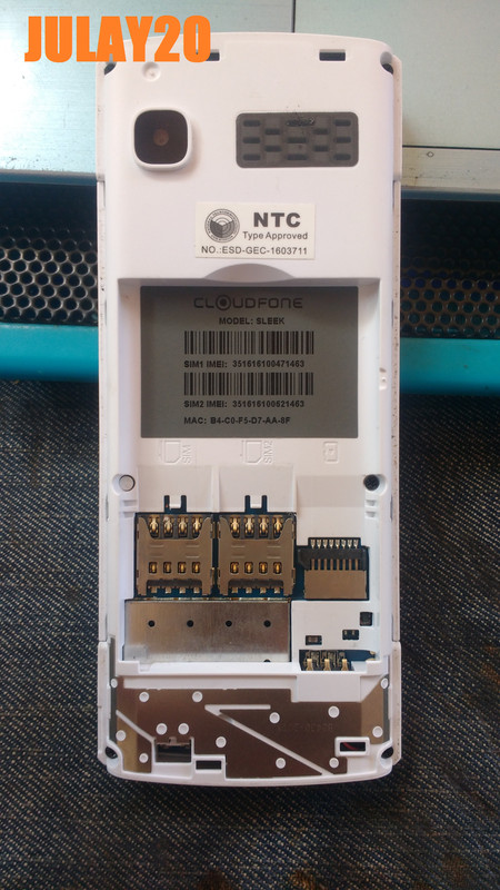

try ko cm2 spd no lock nag rd pero boot key error daw pero ang ic nito spd 6531 kaya nag hanap ako ng na isip ko sa CM2SCR kc pwedi spd ic doon kaya yun pero tery try ko lang hangang nag done

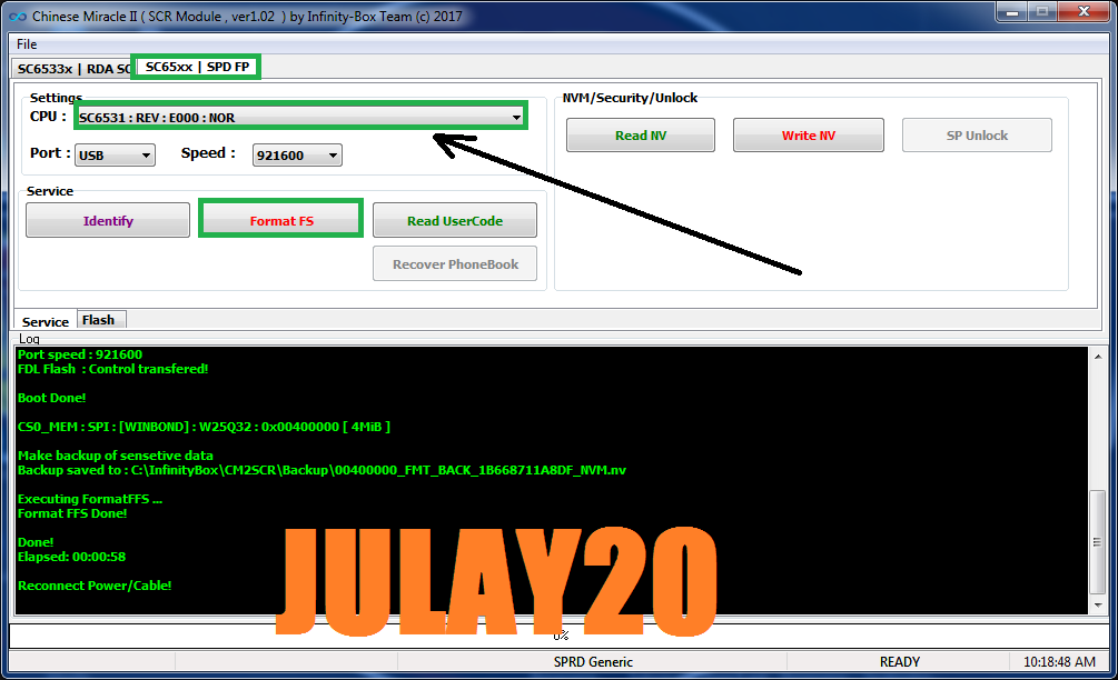

OPEN CM2SCR
CLICK SC65xx SPD FP
SETTINGS CPU SC6531 : REV : E000 : NOR
CLICK FROMAT FS

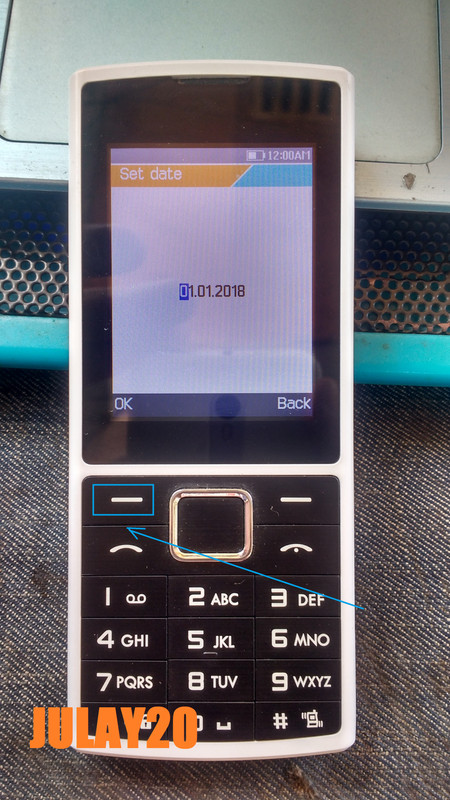

HOLD BOOT KEY YUNG NASA PINA KA UNA SA TAAS UNANG PINDOTAN YUNG SA TAAS NG CALL BUTTON
ito pic
INFO:
Code:
Card found : 6CB042B6 , v0136
Infinity-Box Chinese Miracle II : SC/RDA Module [SCR] v1.02
SCRD mode : AUTO
SPRD mode : SC6530 : REV : 0000 : NOR
SPRD mode : SC6531 : REV : E000 : NOR
Operation : Format FileSystem [ v1.02 ]
1. Power off device
2. Press and hold BootKey or use BootCable
3. Insert cable and battery in device!
Wait for device ...
Device Connected!
BootVersion : SPRD3
BootSource : InternalLibrary
BootVersion : Infinity SCR SC6531E Loader v 1.2
Port speed : 921600
FDL Flash : Control transfered!
Boot Done!
CS0_MEM : SPI : [WINBOND] : W25Q32 : 0x00400000 [ 4MiB ]
Make backup of sensetive data
Backup saved to : C:\InfinityBox\CM2SCR\Backup\00400000_FMT_BACK_1B668711A8DF_NVM.nv
Executing FormatFFS ...
Format FFS Done!
Done!
Elapsed: 00:00:58
Reconnect Power/Cable!
ito yung boot key mga boss ohh kc di ma iwasan mawawala yung mga pic sa furom kaya lagyan ng mga letra para di mawala kahit walang pic
done na po yan ng kinonan ko ng pic
working all di ko ma back up iwan ko di kc ma rd back up sayang
