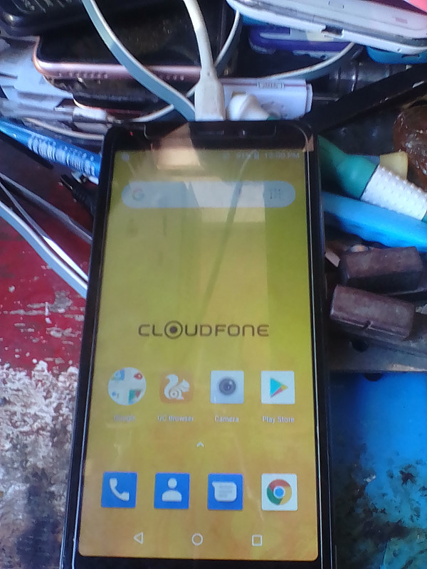

cloudfone thrill boost 2 plus hang on logo done

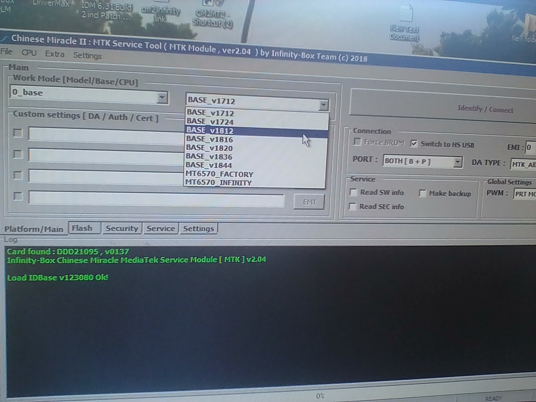

open cm2 mtk v1.58
tick mtk chips
hit format

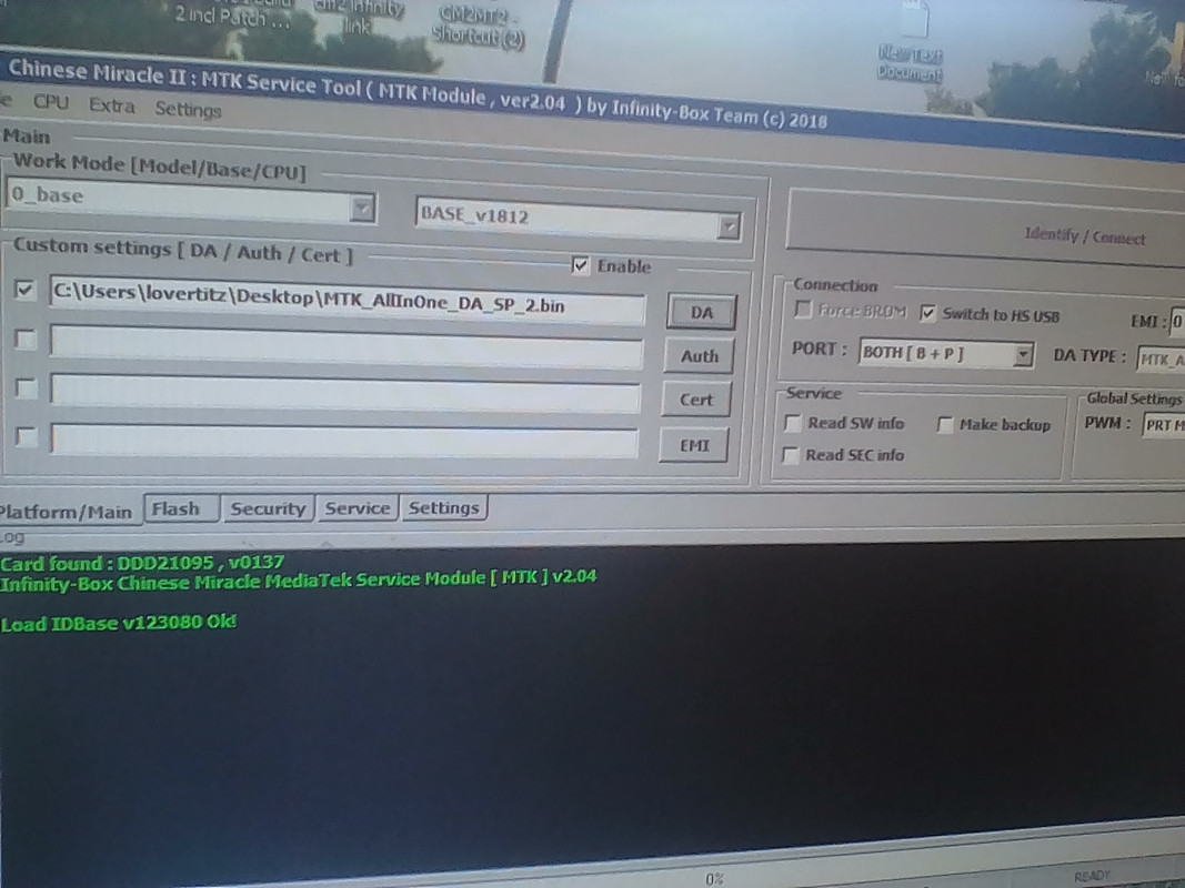

DA error
hanap DA file
http://www.mediafire.com/file/fuc8u3377574aid/MTK_AllInOne_DA_SP.bin/file
load DA file and hit format

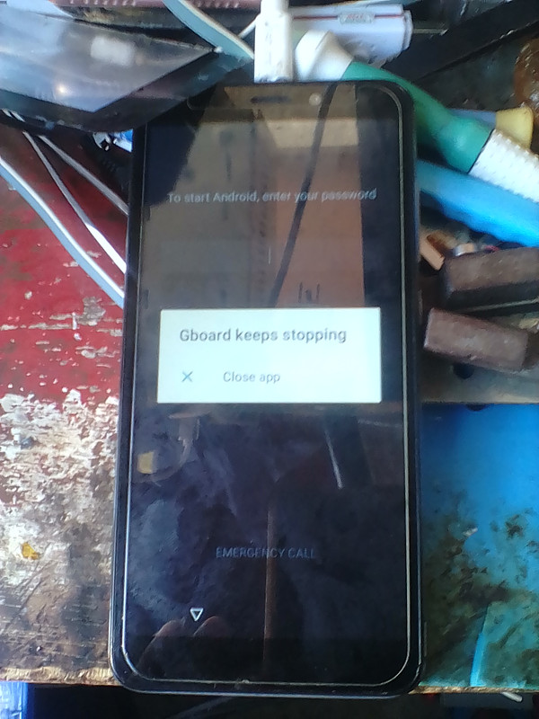

cm2mt2 ibig sabihin v2.04
sudan lang ang procedure

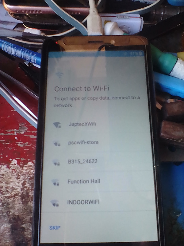

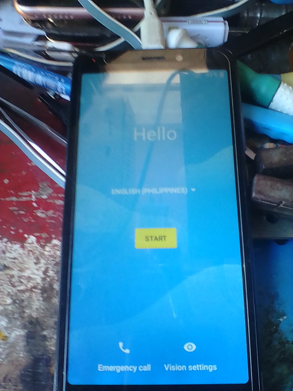

pagkatapos ng format
kailangan HR / hard reset via mahiwagang kamay
binggo
