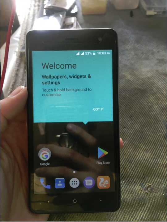

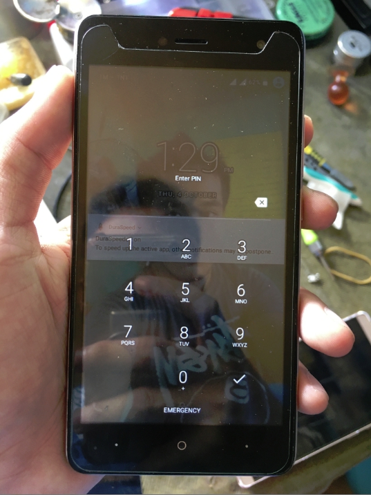

UNIT: CLOUDFONE THRILLBOOST 2
ANDROID 7.0 NOUGAT
ISSUE: FORGOT PASSWORD/ FRP LOCKED
SOLUTION:

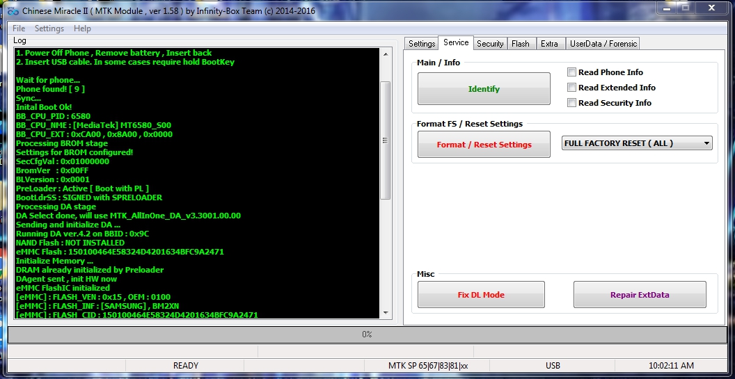

VIA CM2 but DA/BOOT ERROR
DL NYO MUNA TOH
DA/BOOT ERROR
LAGAY MO SA INFINITYFOLDER>CM2MTK>BOOT
OPEN CM2MTK

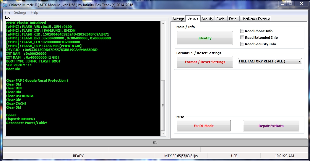

CLICK FOMAT/RESET SETTINGS
SALAPAK UNIT
BOOT KEY: VOLUME DOWN
SMILE NA KUYS OK NA YAN WLA NA ERROR!!
