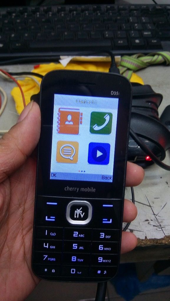

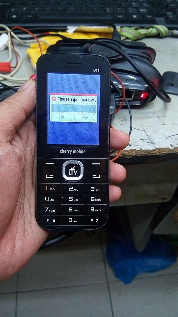

model : cherry mobile d35i
problem : input password
chipset : spd 6531
tools
volcano box
micro usb
bootmode asterisk key (*)
1.connect and open volcano box
2.select spd tab 6531 only
3.read flash then run, connect unit with boot mode put flashfile after read
4.select unlock code and run
5. power on unit then enter the code kung alin ang tumama...
1616 ang code

good job boss..keep on sharing..
TESTED BY ME
