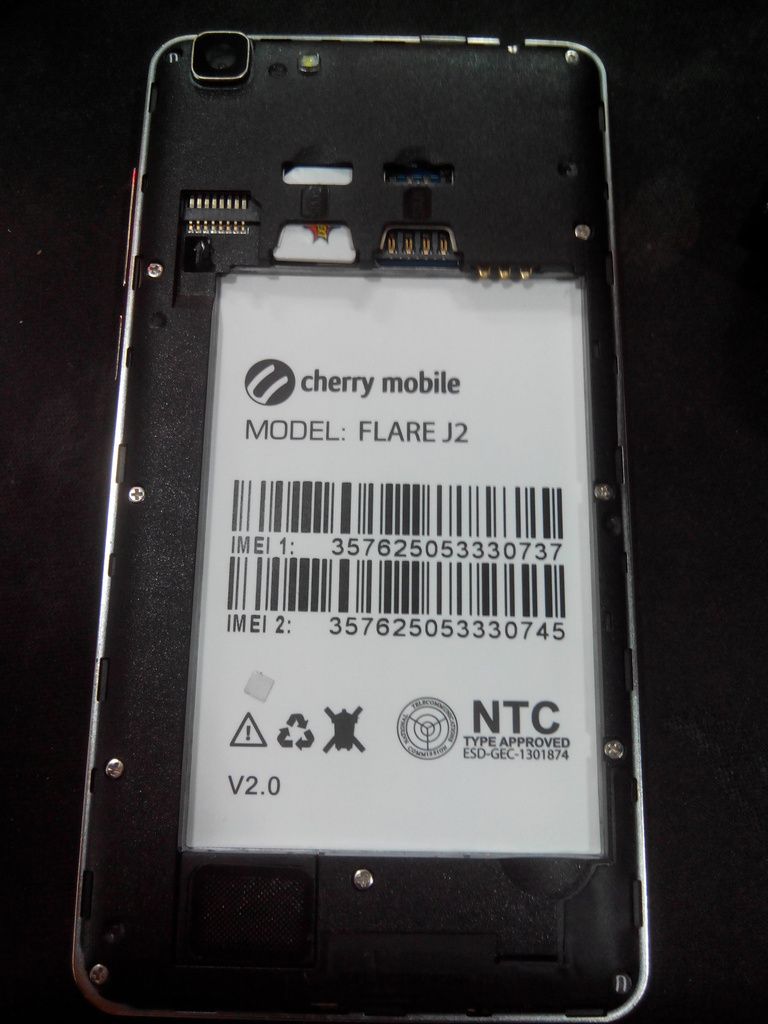

Cm Flare J2 v2.0 FRP Done W Firmware BackUp For Testing

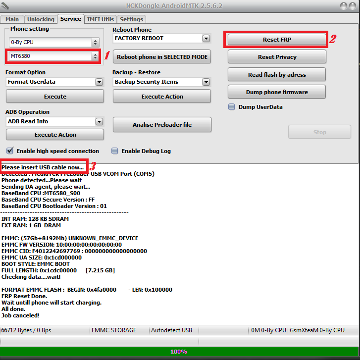

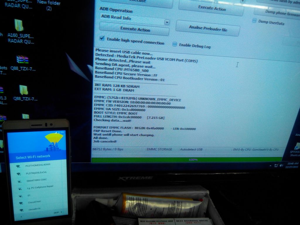

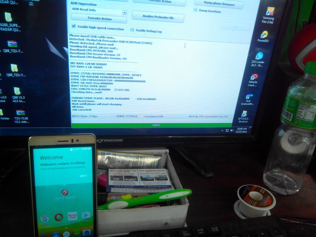

So After Reset Nag FRP.
Try kay NCK Crack at hindi naman ako nabigo
Follow the Step Below.
Eto na siya

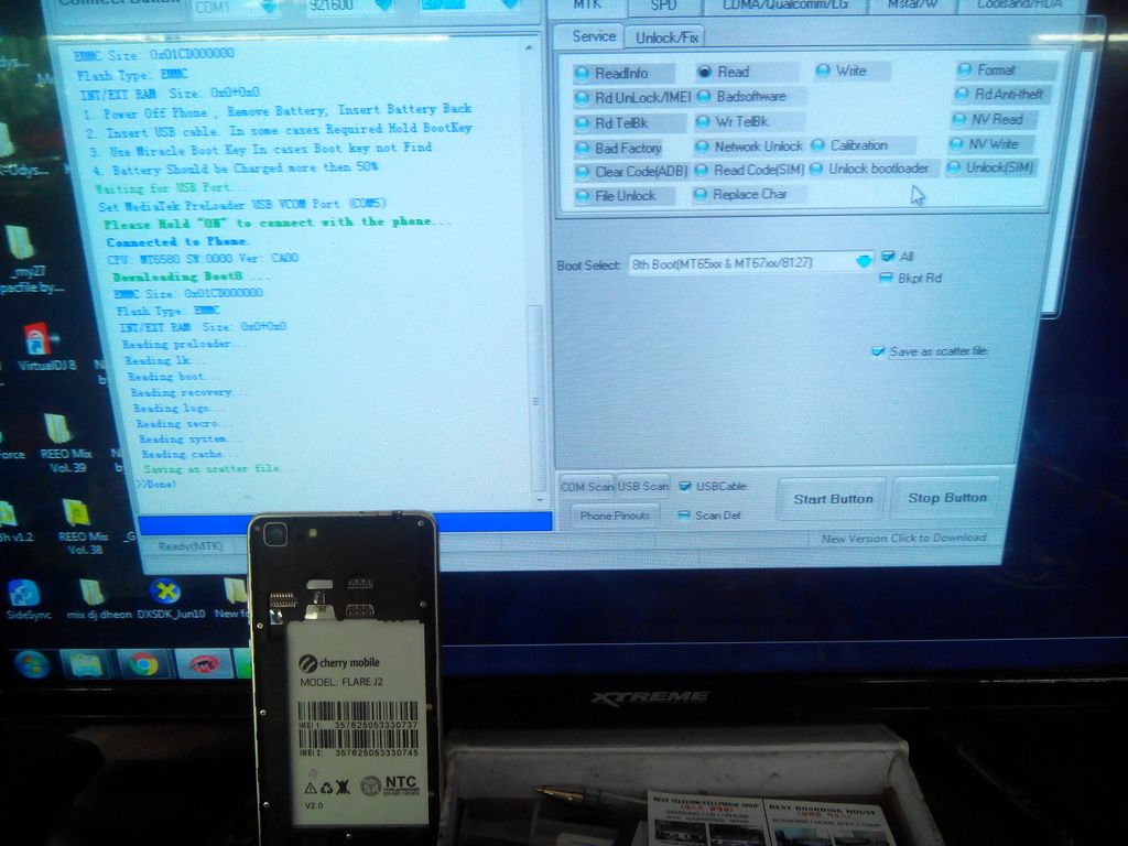

Dahil wala pa si tomer binack up ko na rin sa Miracle Crack. "Scatter File"
https://www.4shared.com/web/directDownload/OyPdg5nzce/hk3i1g.6cf6e9086951210a4fdfe9a2da68e4bf
click this "TRIANGLE Button" for password request ...
Pa testing na lang po if ok. dahil biglang dumating si tomer kaya di ko na test na i flash sa unit.​
