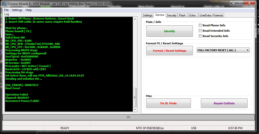

ISSUE: Frp lock, (ni -reset na ni tomer)
Problem:
Solution sana cm2, factory data reset na, kaso DA error
(boot key: hold volume down)

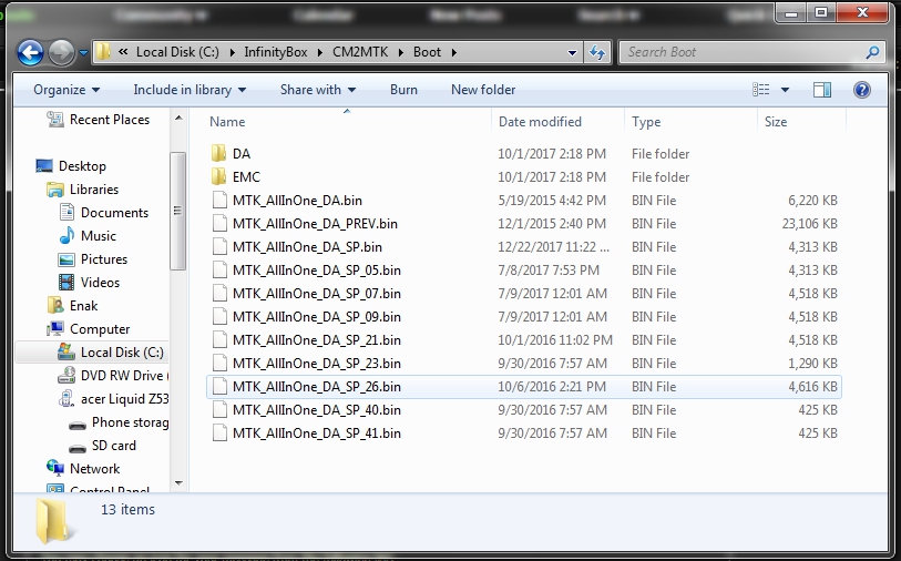

download Boot File for DA error
protected ng password yan pm me/ nsa tatsulok na.
extract nyo lang, ung nagiisang file nyan, copy nyo
then paste to. C file, infintybox folder, Cm2mtk folder, boot folder nyo

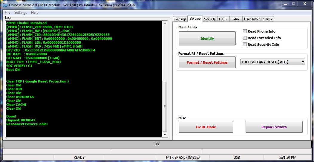

then open cm2, click format/reset settings, hold boot key (volume down), salpak unit

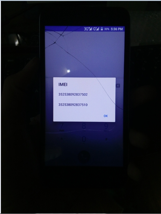

DONE na boss, ok din imei.
