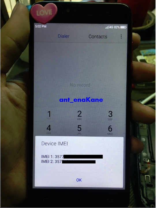

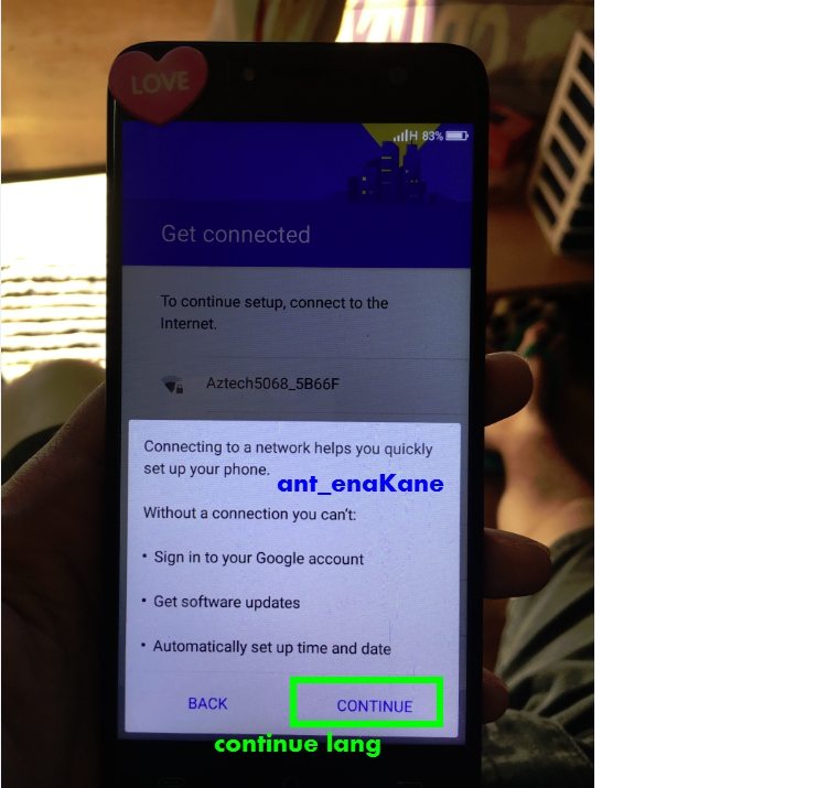

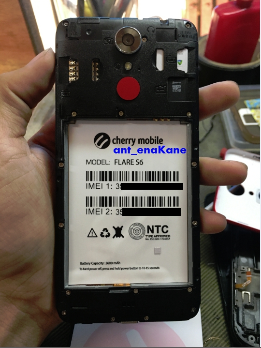

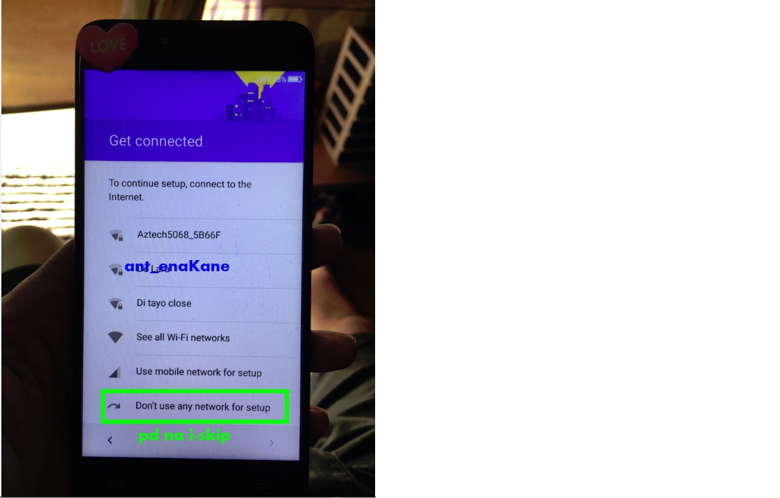

UNIT: CM FLARE S6
ISSUE: FORGOT PASSWORD

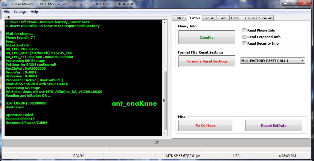

PROBLEM: DA ERROR SA CM2
SOLUTION:

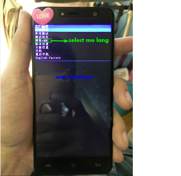

GINAMIT ANG MALIKOT NA KAMAY
(FACTORY MODE LANG MGA BOSS)
HOLD VOLUME DOWN AND POWER BUTTON
PAG LUMABAS LOGO BITAW LANG POWER BUTTON
ETO LALABAS
CLEAR EMMC YAN (FORMAT/RESET)

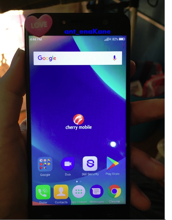

DONE MGA BOSS (l:0 (l:0 (l:0 (l:0 (l:0
