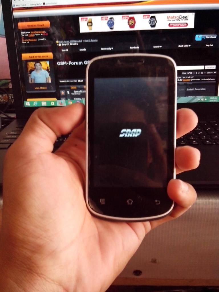

problem: hang in logo
unit:CM snap v2.0

hang in logo

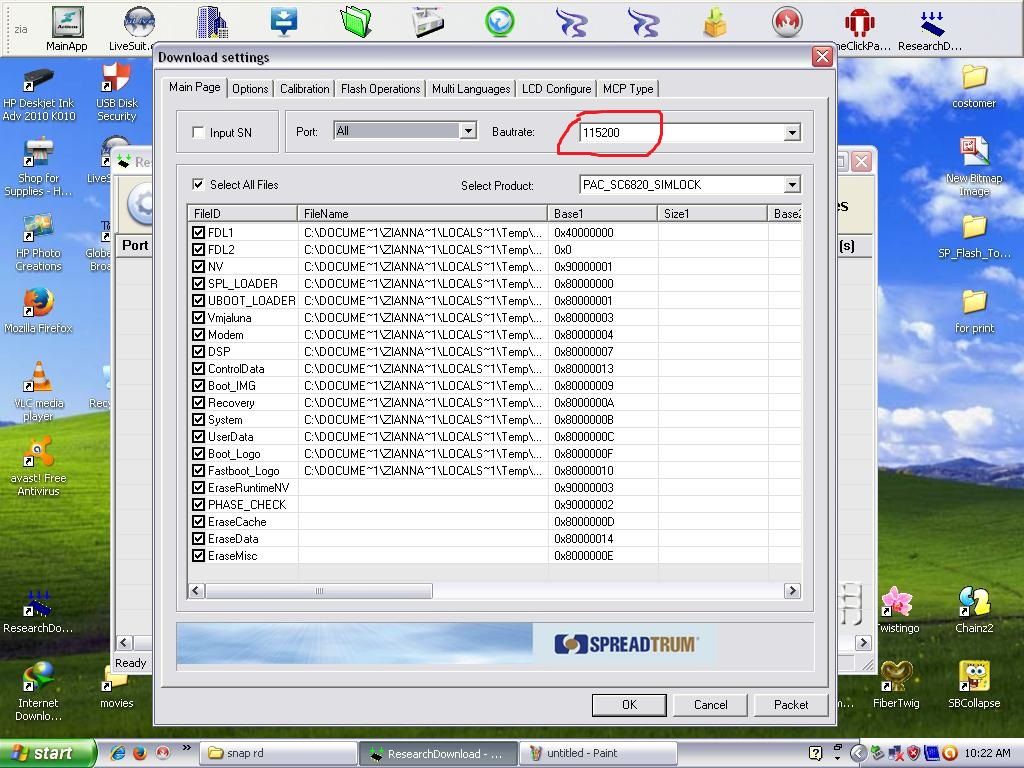

1st step open researchdownload then click the gear inside the read box to load the firmware
2nd step after loading the firmware click the 2nd gear na nasa katabi lang ng 1st gear and change the bautrate to 115200 and click ok

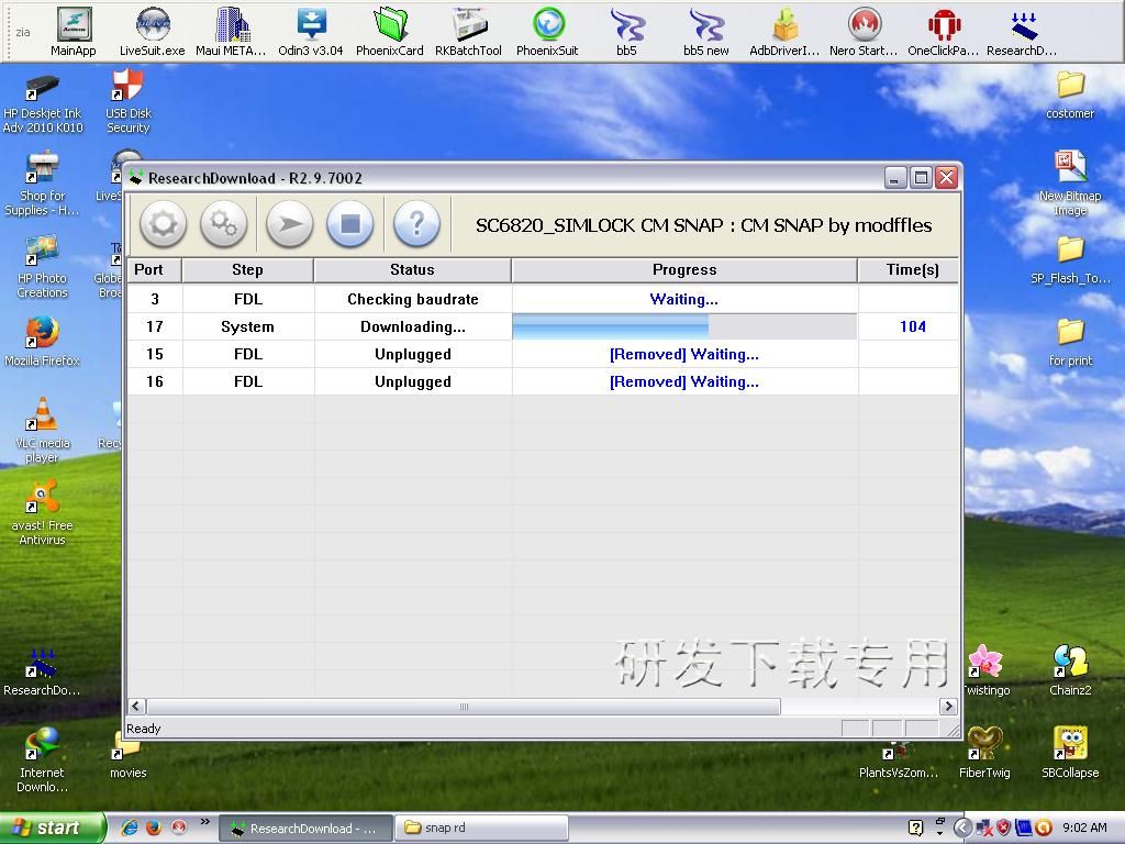

3rd step click the play botton
4th step turn off phone then get battery for 15 sec. then put the bat. back with out turning on the phone
hold volume down then connect agad usb cable. pag nag start na ang flashing pwd na unhold volume down antayin hanggang matapos

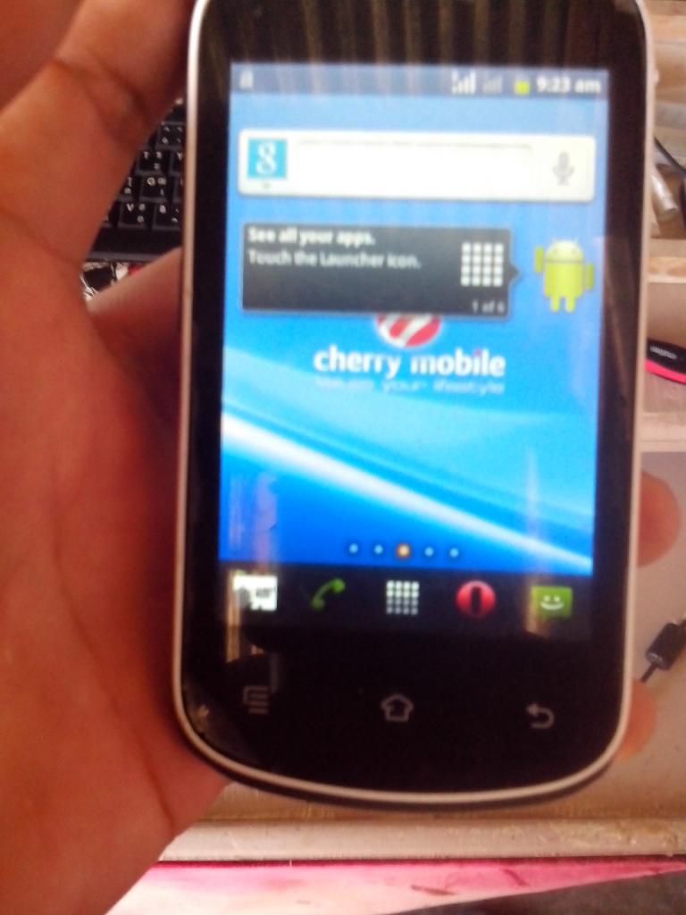

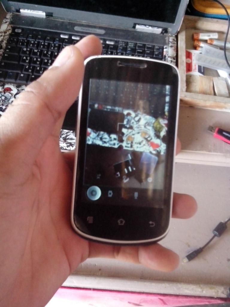

ito po finish product
done
