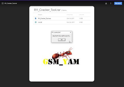

tool error ito sondan mo :
download tool : here
password : aungthuphyo
tool video tut link :
SUPPORT MODELS : A73,A83,F5,A71,A77,R11S,A77,A37FW,A57,A37F,F1S,R9S
tool picture :
unit picture:
