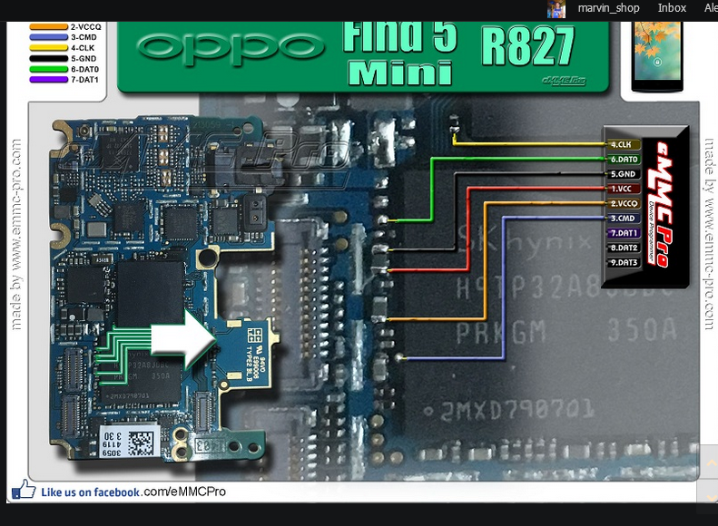

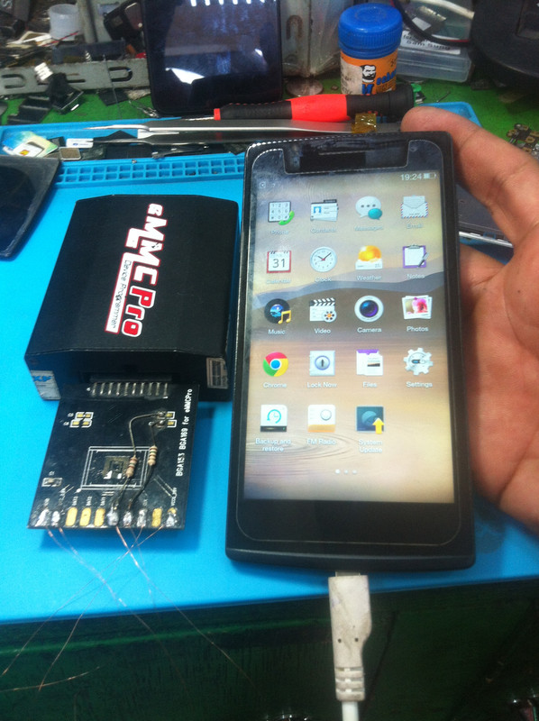

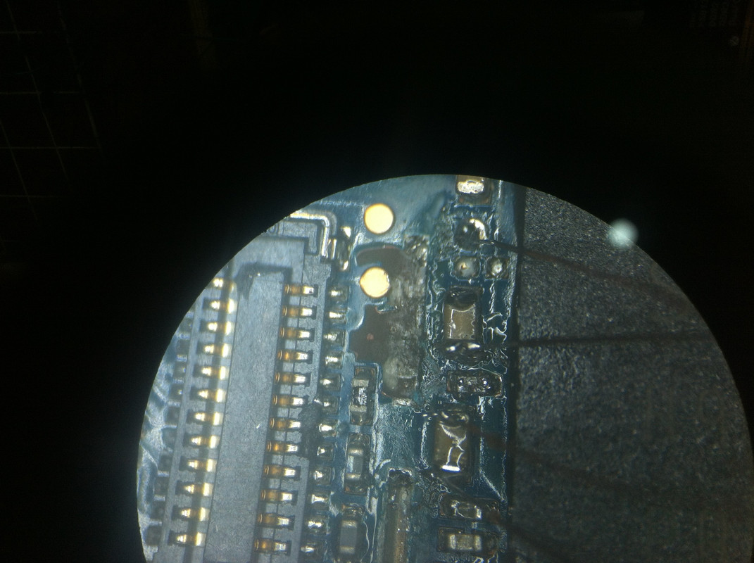

history pasok akin dead po oppo r827 so check supply jtag problema

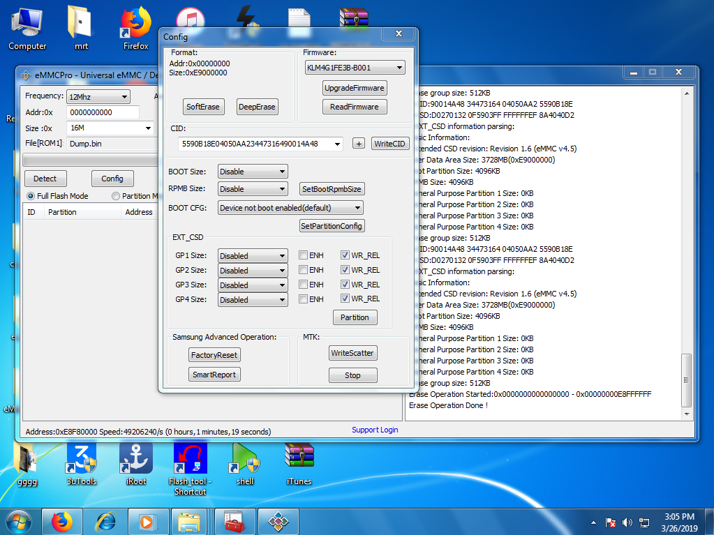

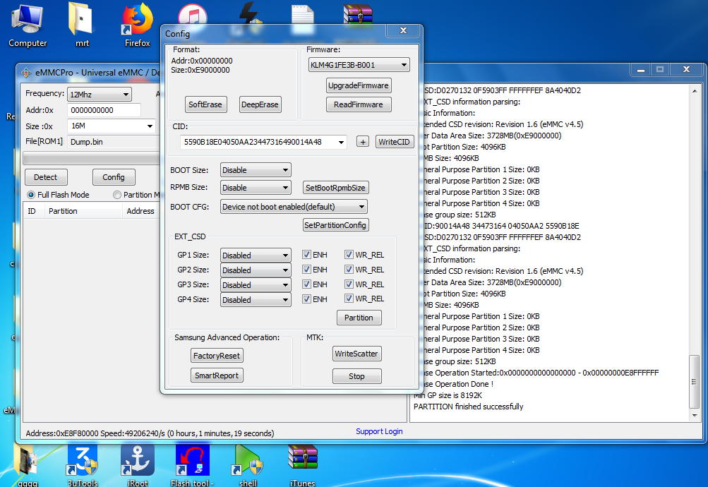

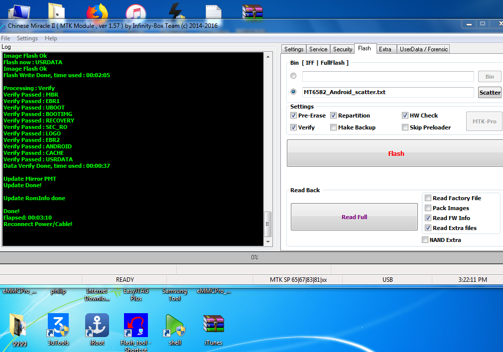

procedure:solda wire sa pin-out oppo r827 ,connect punta config,deep erase, partation pagkatapos flash firmware oppo r827 linkhttps://www.4shared.com/rar/TbNUjaYLce/MT6582__OPPO__R827__R827__422_.html pag ok rebuild emei

nice post boss kaya lang di malinaw procedure step by step po sana idol
pero ng galing mo tyaga ka :D mga ganyan ina ayawan ko na :D

boss anung status nung emmc nya sa cm2 bago mo e-deep erase,naka read only na ba?
