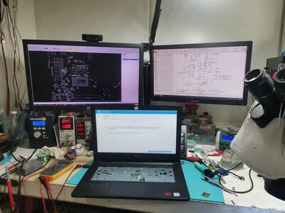

Model: Dell Inspiron 14-3478
Issue: No Display

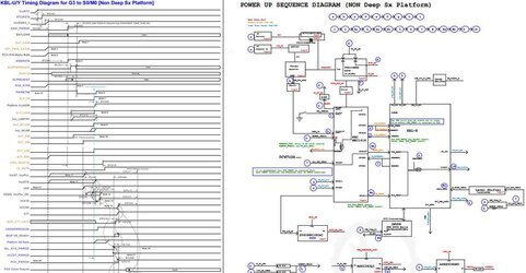

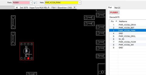

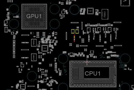

No display causing 1.05VO missing not to function the PCH itself. +vccsa is responsible for powering up the CPU and communicating the PCH even if it's in a single package. however, in the same field of PU5001 voltage signal or PWR_VCCSA_PWM is missing. that's why the vcore does NOT function as needed by the CPU to activate its function to send or gather the data from another chipset.
