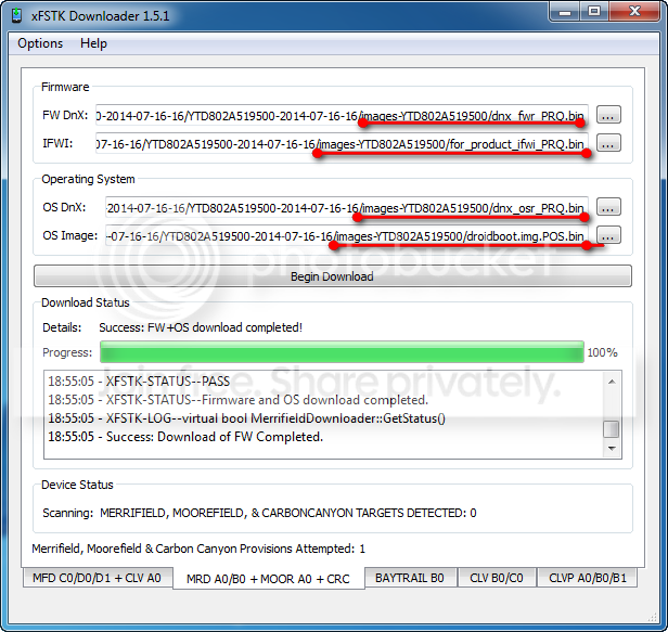

1) Open Flash Tool “xFSTK-Downloader”
2) Select the second “MRD AO/BO + MOOR AO + CRC” tab as the following:
3) Set GP Flag to “0x80000007” in “Download Options” tab as below:
4) Select Firmware files as the following from SW Image directory:

6) Click “Begin Download” in Flash Tool, it will display waiting time is 60 seconds.
7) Long press the volume up button and then plug in the cable.
8) When flash process started, then release the volume up button.
9) When firmware flash is done, Flash Tool will show Success: FW+OS Download Completed!
10) After flashing firmware, the tablet device will switch to fastboot mode automatically as the following:
