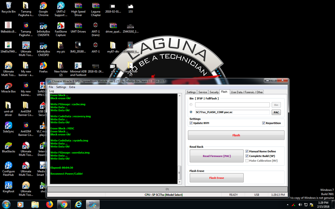

CM2 @ USB CABLE
PROCEDURE
-Open CM2 then select SPD Module
*Extract file after download
*Click Setting TAB
*Select CPU mode SP [SC7730..SC7731] eMMC [Crev/Android 6.x]
*Select Flash tab
*Select PAC button to select PAC FILE
*Check update NVM before Flashing
-Open device phone
*Press Volume down
*Insert Usb cable
*Just wait until write data ok
FWhttp://www.mediafire.com/file/udrxx2bs4n7bsqe/Defi_Phantom.rar
password: pass
ANT-GSM
21VOLCANO-LAGUNA-CHAPTER

log's
Code:
======= Flash
Files set for flashing :
[ MCU ] : SC77xx Infinity Package
1. Remove battery. Insert battery back
2. Press and hold 'VolumeUp' and 'VolumeDown' keys
 -> Alternative : just ONE 'VolumeUp' or 'VolumeDown' key
3. Insert cable
 ====  Wait for phone...
Phone found! [ 3 ]
Port Opened
Sync...
InitBoot Done [ 0x81 ] , Ver : SPRD3
Sync...
Sending FDL
[Info] : If SW freeze here more, than 15 seconds - remove cable
FDL Ready!
Boot Ver : SC7731 Crev eMMC Loader v2.0
Sending FLASH FDL
FLASH FDL Ready!
Boot Ok!
FlashMode Set : Ok!
[FL] : Enabled NVM update. Will program all NVM images found in FW !
PMTManager : Load 0x19 records
PMTManager : PMT Update Ok!
Flashing now
Update BootCode : u-boot-spl-16k.bin
Write Data ...
Write Data Ok!
Update BootCode : u-boot.bin
Erase block ...
Block erase Ok!
Write Data ...
Write Data Ok!
Write FSImage : prodnv.img
Write Data ...
Write Data Ok!
Write CodeData : sc7731C_CP0_modem.bin
Write Data ...
Write Data Ok!
Write CodeData : DSP_DM_Gx.bin
Write Data ...
Write Data Ok!
Update NVM image : nvitem_w.bin
Update NVM Data Ok!
Erase Block : RuntimeData
Erase block ...
Block erase Ok!
Write CodeData : sc8830g_modem_CP2_WCN_Trunk_W17.27.4_Release.bin
Write Data ...
Write Data Ok!
Update NVM image : nvitem_wcn.bin
Update NVM Data Ok!
Erase block ...
Block erase Ok!
Write CodeData : logo_540x960.bin
Write Data ...
Write Data Ok!
Write CodeData : fblogo_540x960.bin
Write Data ...
Write Data Ok!
Write CodeData : boot.img
Write Data ...
Write Data Ok!
Write FSImage : system.img
Write Data ...
Write Data Ok!
Erase Block : PERSIST
Erase block ...
Block erase Ok!
Write FSImage : cache.img
Write Data ...
Write Data Ok!
Write CodeData : recovery.img
Write Data ...
Write Data Ok!
Erase Block : MISC
Erase block ...
Block erase Ok!
Write CodeData : sysinfo.img
Write Data ...
Write Data Ok!
Write FSImage : userdata.img
Write Data ...
Write Data Ok!
Elapsed: 00:04:30
Reconnect Power/Cable!
