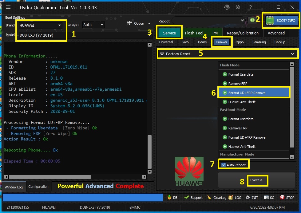

1. select brand and model
HUAWEI
DUB-LX3 (Y7 2019)
2. BOOT/INFO
3. after done booting info select SERVICE tab
4. select Huawei below
5. select factory reset
6. select Format UD+Frp remove
7. check auto reboot box
8. Execute.
then manual wipe data after reboot.
HUAWEI
DUB-LX3 (Y7 2019)
2. BOOT/INFO
8. Execute.
