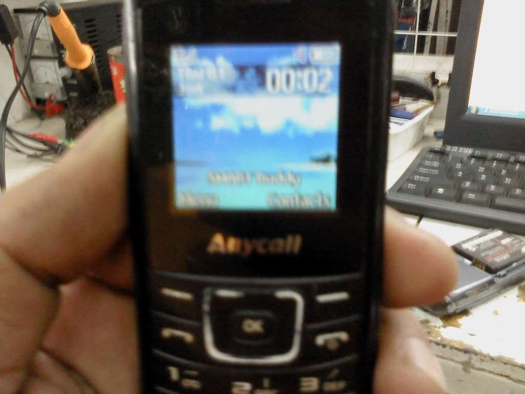

share ko lang mga boss kanina ko pa ginagawa itong unit e1100h anycall
no power po.....galing na po sa ibang mga shop hnd po nila mabuhay
pag flash nyo po talaga ito sa kanyang file hnd po talaga mabubuhay kahit complet flashing...
kaya nag try din po ako convert sa e1100t...
Selected model: E1100T
Selected com port: COM9
Selected speed port: 921600
Please, connect phone and press power button 3 seconds
Phone Detected
Sending loader1... OK
Flash ID: 54
Sending loader2... OK
Start TFS format... OK
Start NOR flash
NOR flash - ok
Start Flash TFS
Download - ok
Elapsed time: 488 second, sw ver: 3.5.0035
ayun dun po nabuhay.....
ganito po ung flashfile nya...........e1105TJCID1
Sana nakatulong sa baguhang tulad ko​
