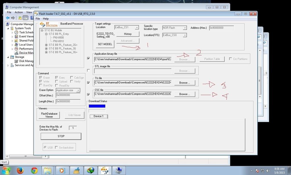

procedure
1st:> pick nyo po :>E2222_TEXTO_Setting_v00.mdl
2nd:>pick nyo po :> E2222XE.ptt
3rd>pick nyo po :>E2222XEKD4.tfs
4rt>pick nyo po :>E2222OXEKD6.csc
install nyo muna ung driver ung naka folder ng >Sunstone_V5_00_0_1_WHQLed<
tapos nyo mainstall
pindotin nyo muna ung Q+A tapos salpak nyo na sa pc wait nyo nalang matapos
firmware:>http://www.4shared.com/rar/UruwsaBXce/E2222XEKD4.html
flashloader:>http://www.4shared.com/rar/CitZftcEba/Flash_loader_747_SSG_v01_Lite.html
PASS:>> RHAIZEN<<

procedure
tapos nyo mainstall
PASS:>> RHAIZEN<<

try this 100000000000000%
press q+w+a+s together and connect usb cable
procedure
tapos nyo mainstall
PASS:>> RHAIZEN<<
goiod work boss... tested sa bootloop na unit... thanksss
tested boss.salamat
procedure ginawa ko ay sabay pindot sa 4&5 salpak w/o batt.
