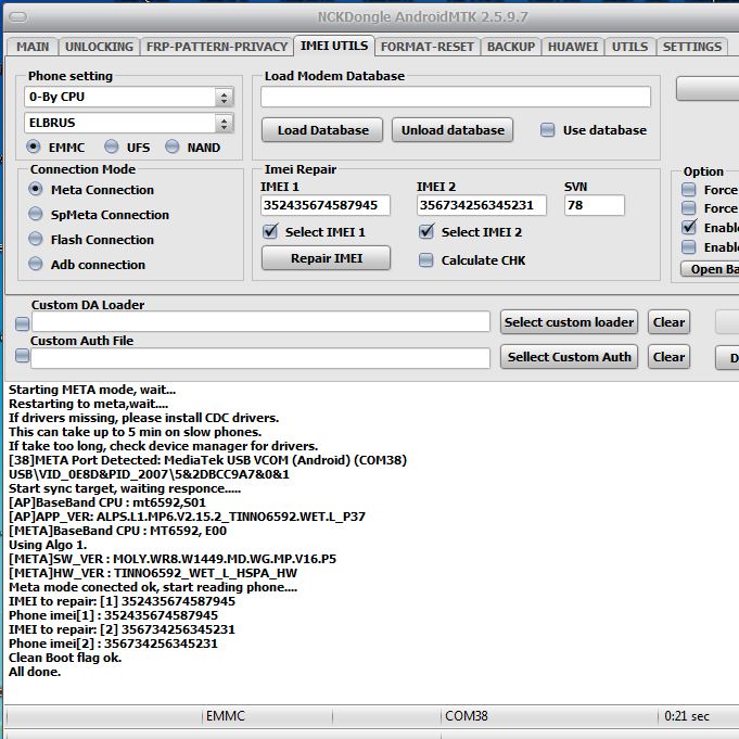

1-share q lng mga boss invalid imei unknown baseband pa so naisip q munang gawin
ifxed baseband sa cm2 dongle open cm2 tck extra tick fix unknown bb
pagkatpos po nyan invalid parin yan.pero my bb na po sya
cnsya na dq screen shot yung unang nagawa.
2-nckpro dongle repair imei ito po katibayan

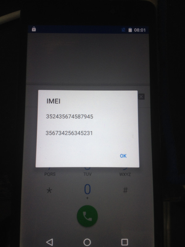

ito nmn po nung my imei na
[url=https://postimg.cc/BjLtc8VW][/url]

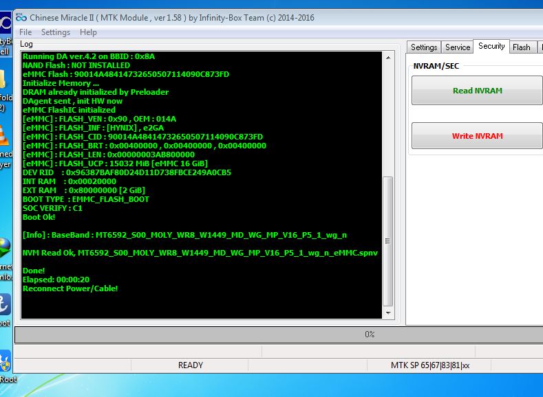

ito sa pag back up nang nvram
[url=https://postimages.org/][/url][url=https://gasstation-nearme.com/]shell gas finder[/url]
ito po ang nvram
https://www.mediafire.com/file/wkv9xrxvvx7fwan/MT6592_S00_MOLY_WR8_W1449_MD_WG_MP_V16_P5_1_wg_n_eMMC.rar/file
