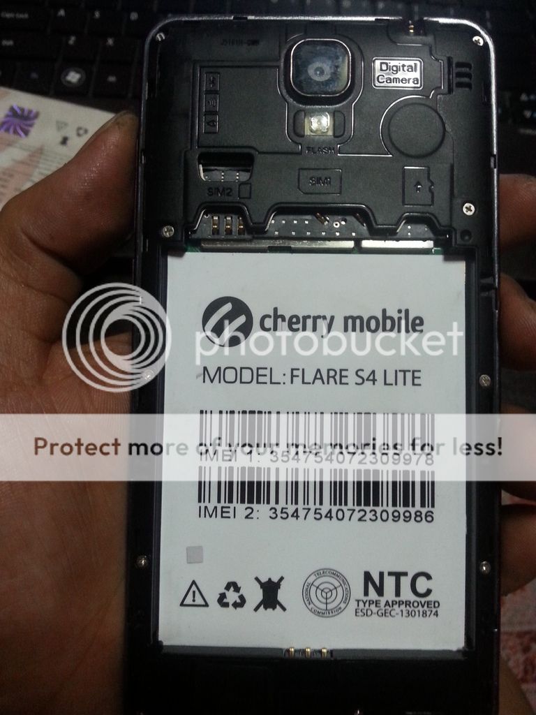

flare s4 lite [verify google account]problem done spft./miracle cracked

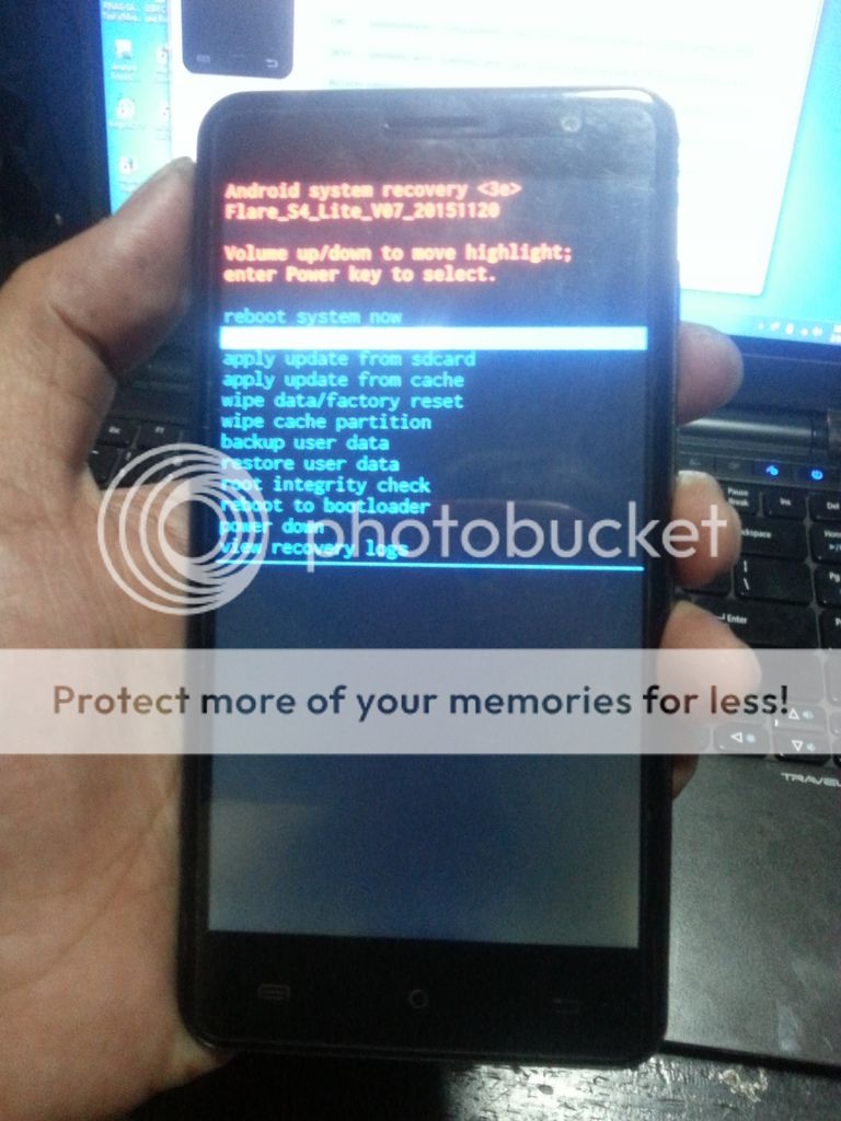

2ND..HARD RESET BUT STILL THE SAME......

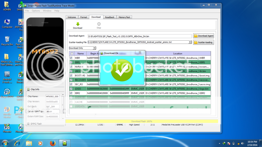

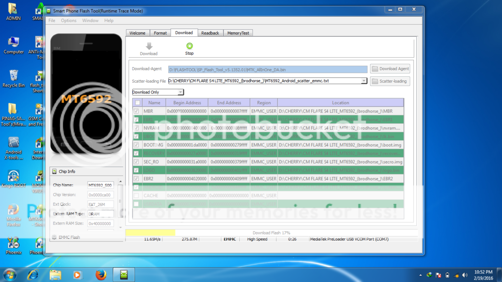

3RD...MOVE I DECIDE NA FORMAT ALL + DONWLOAD KAY[ SPFT.]SA MASAMANG PALAD NADEADBOOT ANG UNIT..
KAYA HANAP-HANAP PA KO NG SOLUTION..HINDI NAMAN AQ NABIGO..

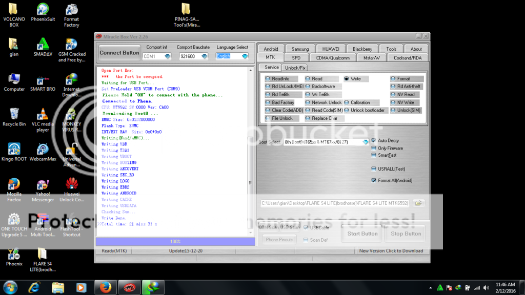

MARAMING SALAMAT KAY BOSS [BRODHORSE]...PINAG SAMA KONG GAMITIN UNG BIN FILES AT STOCK ROM.. NYA..

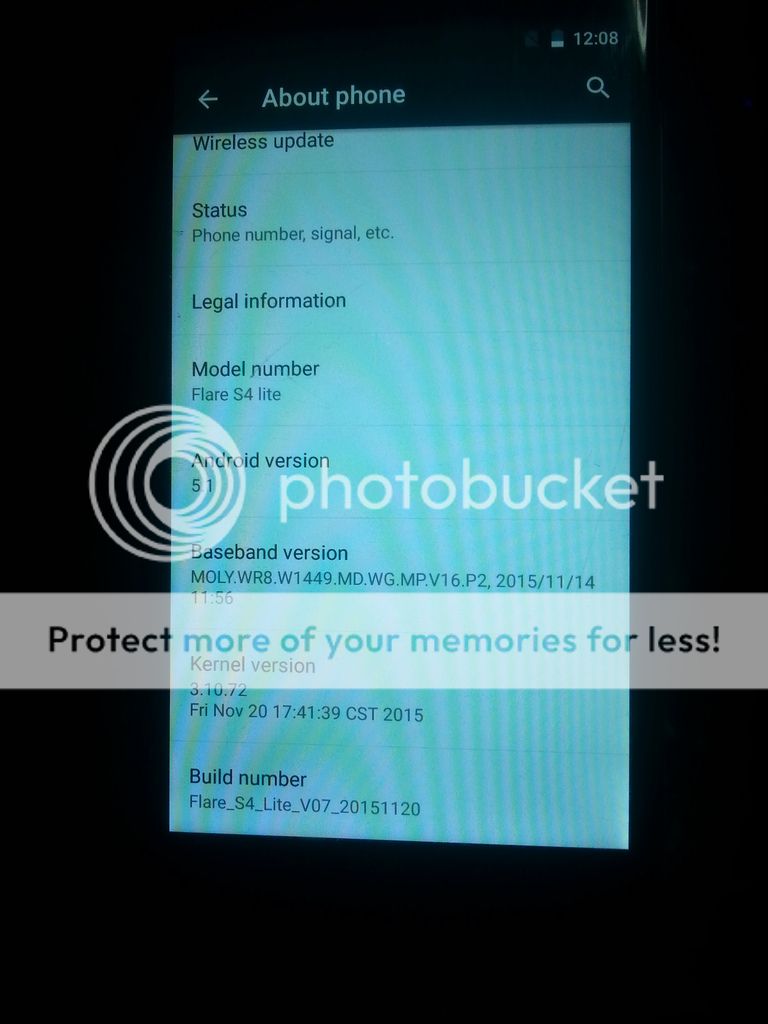

4TH. I DO FLASH KO MUNA SA BIN FILE USING[ MIRACLE CRACKED] THEN DOWNLOAD ONLY KAY SPFT...LAKING GULAT KO NABUHAY HANG ON LOGO,,KAYA HARD RESET KONA AGAD AYUN SAPOL...
