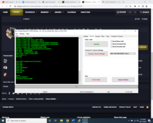

Nung dinala sakin ni tumer ang kanyang s7 power ay naka hang logo, triny ko sa hardreset nakuha naman,pero may frp.
Ang ginawa ko open cm2 mtk
Sa settings as always,click SP AUTO.... gaya nung nasa picture.
then click service gaya nung nasa picture at iselect ang FRP(RESET PROTECTION
then click format/reset settings
Salpak mo usb,vol - ang bootkey then wait until done✓
