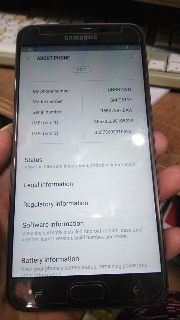

Share Ko Lang GAwa Ko Na J7 Prime 2 Latest Security Patch

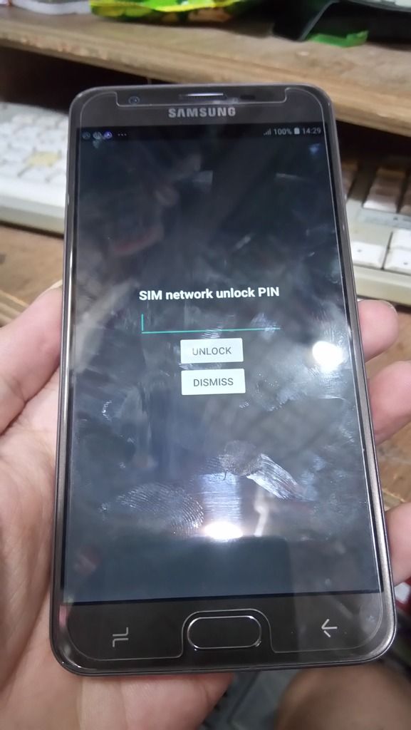

Issue : Naka-Lock (Hindi OpenLine)
Solution : DG Ko sa 7.1 Para Ma-ROOT ~X(~X( (l:0 (Wag Po I-ROOT Kung Di Pa Na DG Kasi Mag Block SCREEN YAN KAYA Please DG First Before Root)
Take Note : Tested Ko po To kaya Wag Matakut Basta Sundan Lang Step By Step heheh

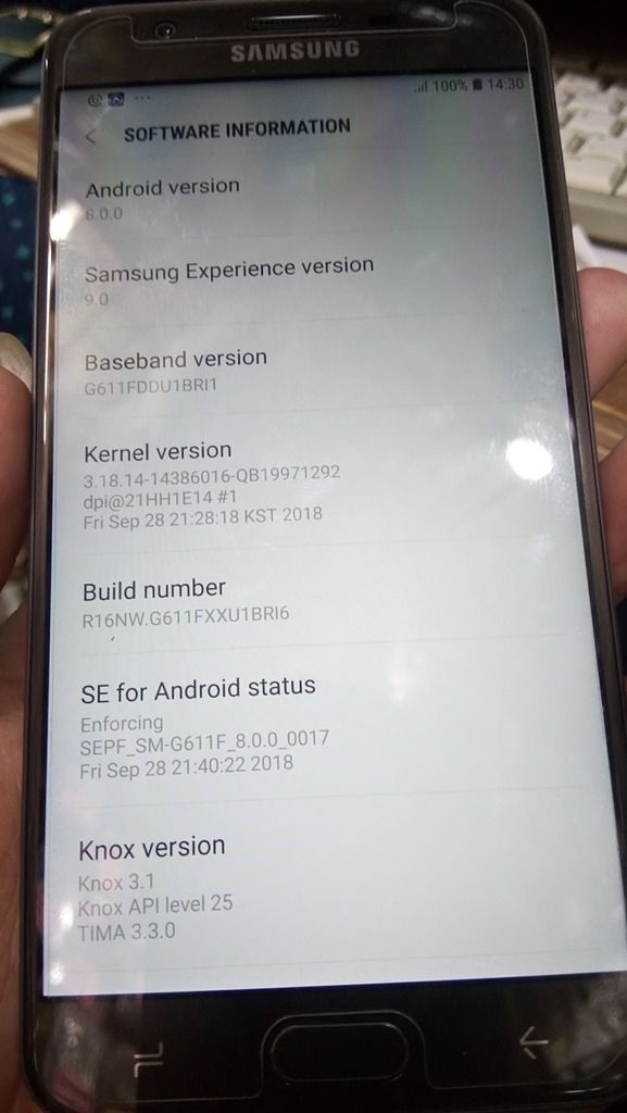

Eto Ung Unit

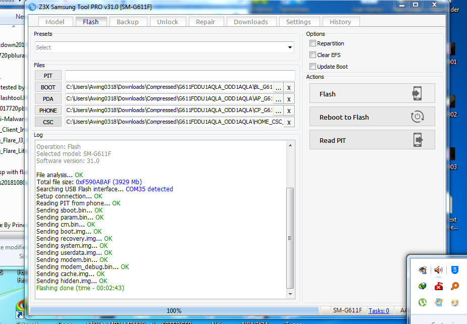

SECURITY PATCH LEVEL

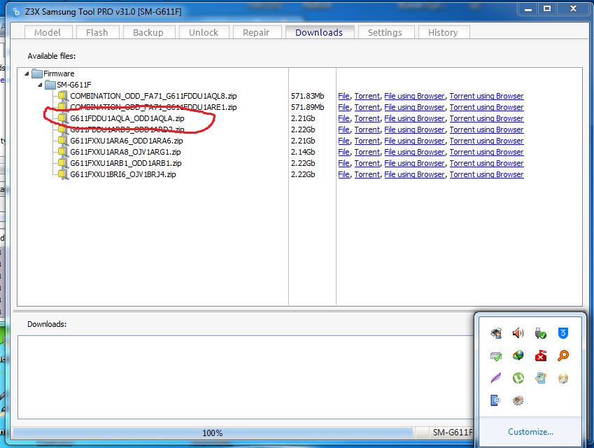

ETO GINAMIT KUNG PANG DOWNGRADE SA Z3X Support PO TO
DOWNGRADING PROCESSED

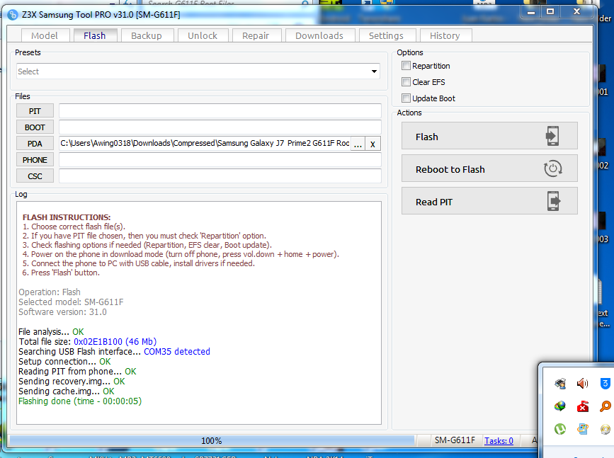

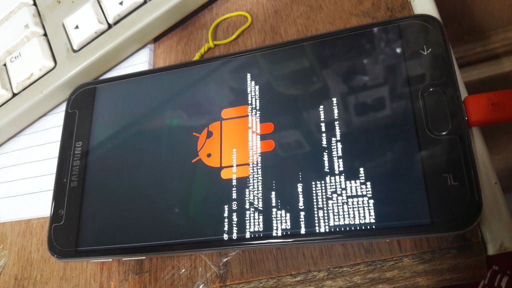

After DG Rooting Na Tayu Eto ROOT PROCESSED
Note : DALAWANG BISIS AKO NAG ROOT KASI NUNG UNANG ROOT KO MAY NAG APPEAR NA RESET heheh~X(~X(~X( AFTER MA RESET ROOT ULIT 100% ROOTED NA YAN MGA BOSSING heheh

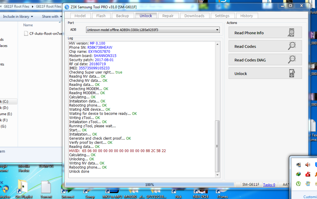

AFTER NG ROOT UNLOCKING NA FINAL NA SALANG EHEHEH :-bd:-bd:-bd[-O{[-O{
FINISHED (l:0(l:0(l:0(l:0
