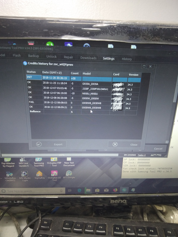

prove na walang credit n consume
sa logs palang 0 credit consume
finish product....

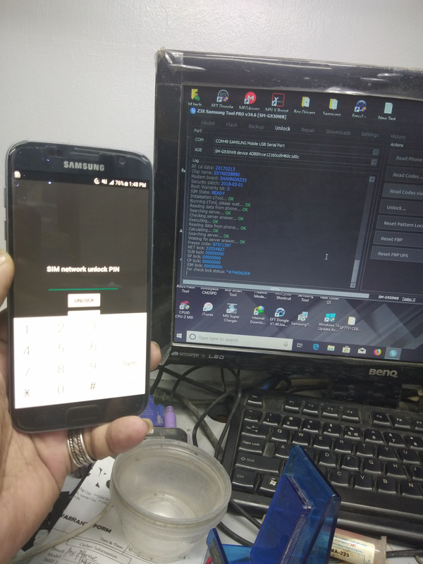

isa pang g930w8 unlock for free no consume credit...
enable usb debug and on oem pagkatapo punta sa dial pad
type *#0808#
iselect yun pinakababa...
then open z3x connect unit after installing driver and set to proper port
hit read unlock by server...

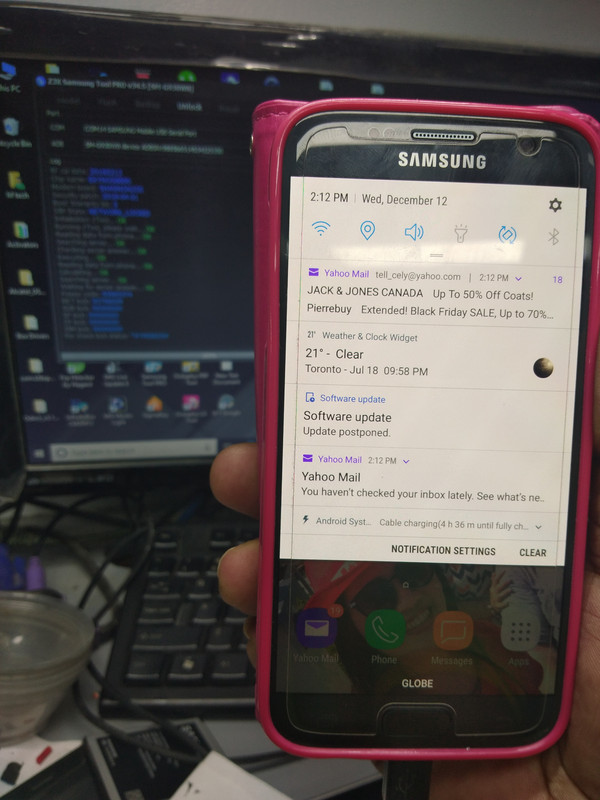

then enter the read code by server...:D:D
no credit consume..
