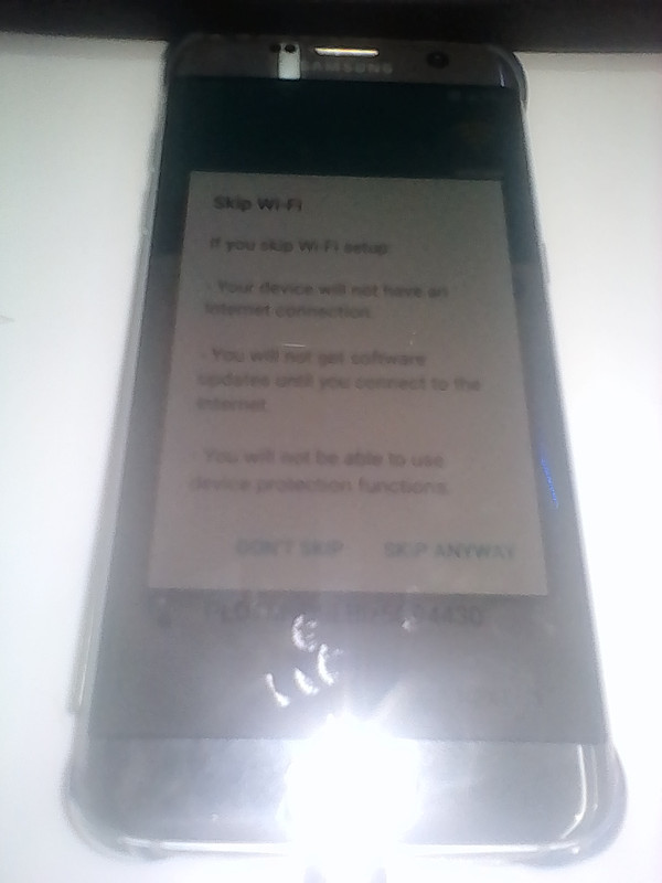

Share ko lng mga ka ANTECH!!!
G935A (S7 edge) FRP LOCK

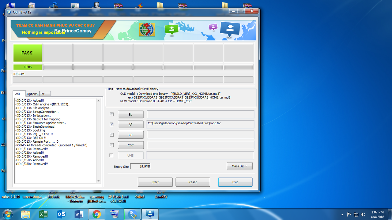

1st. dlod this FILE
2nd. flash it to odin AP tab. to enable ADB.
after flash magrerestart ang phone,

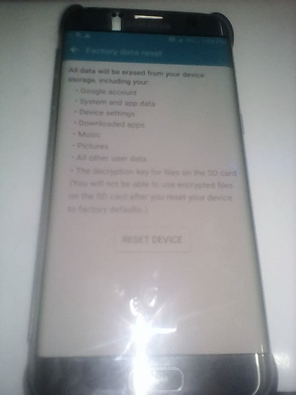

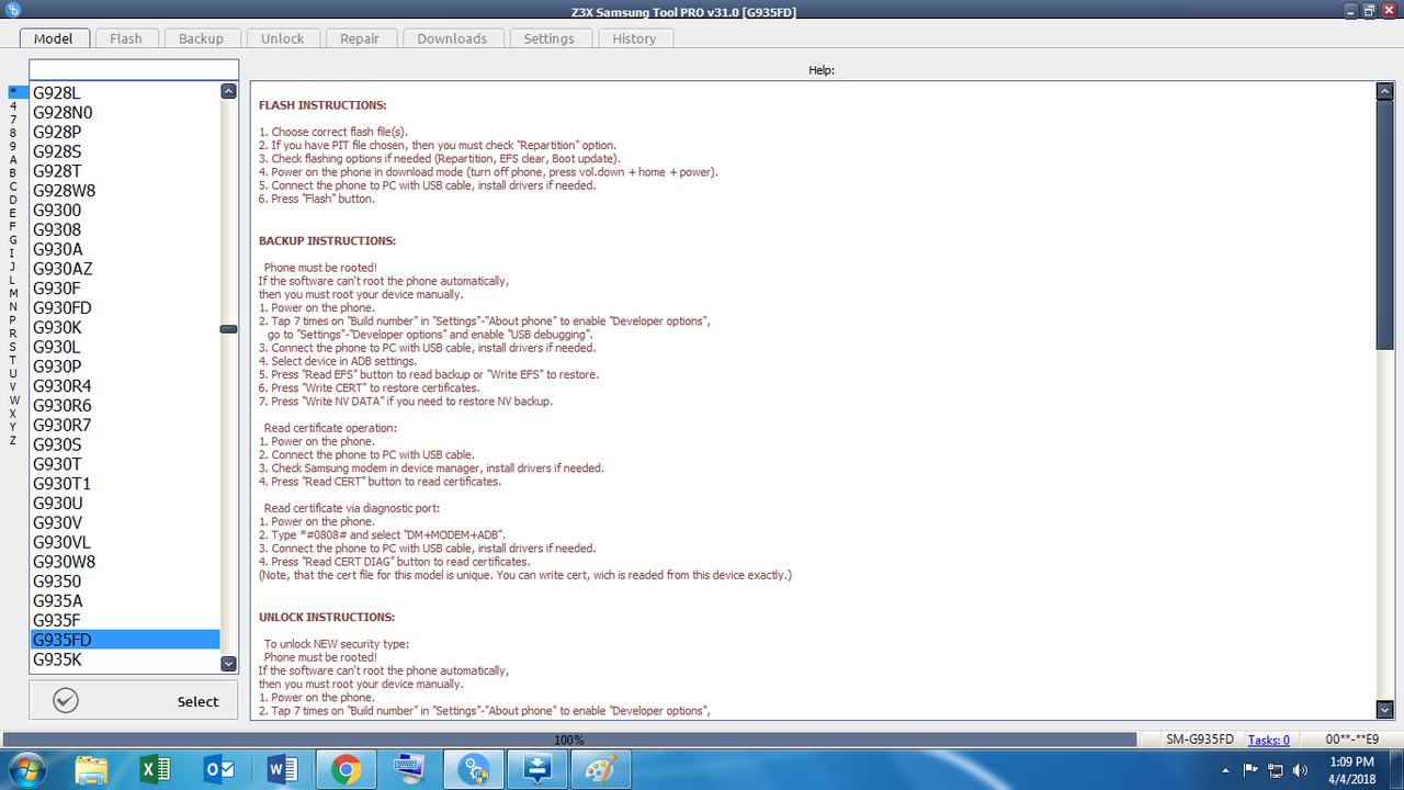

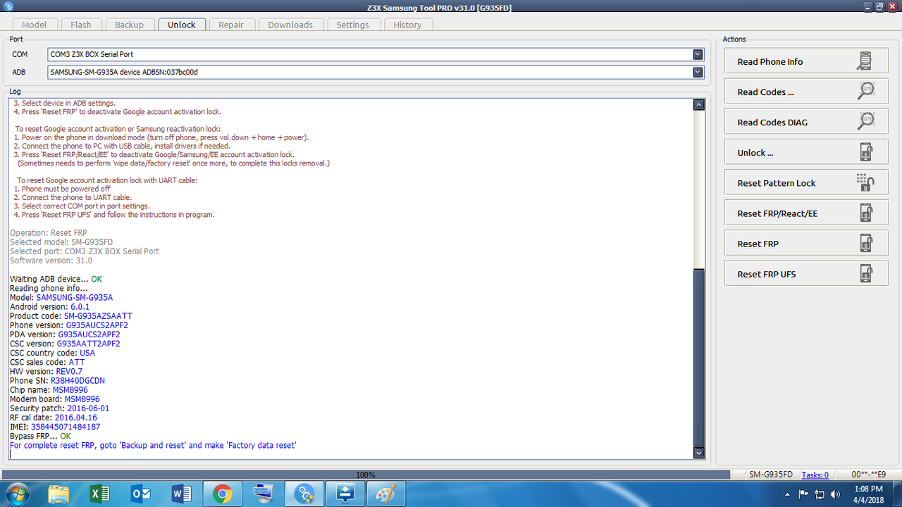

3rd.Open Samsung Tool PRO, at dahil wla reset FRP tab ang G935A kaya select G935FD dahil may nakita ako G935F peru no luck. after reset may FRP parin.
then click RESET FRP.

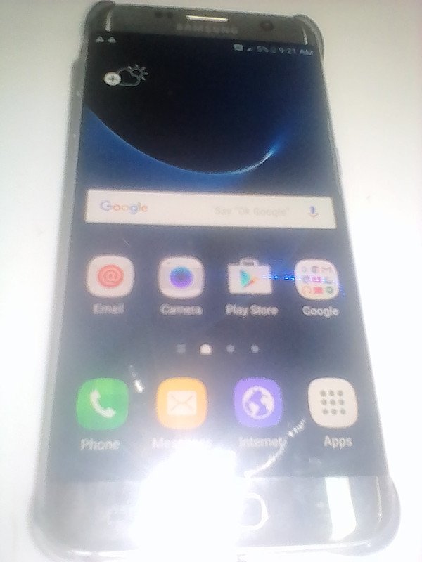

FINISH PRODUCT.
HIT THANKS BUTTON FOR PASSWORD
"ANT GSM BACOLOD CHAPTER"
pasword: cojager
