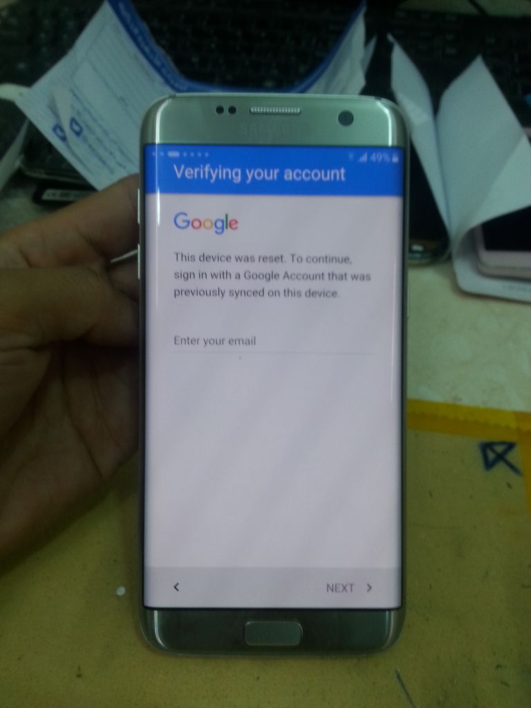

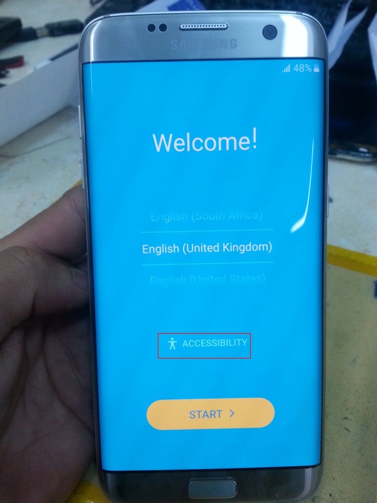

UNIT: G935F
PROBLEM: Gmail (frp on)

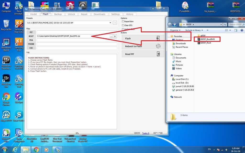

First download this file
http://www.4shared.com/file/jpMsG4exce/G935F_BootIMG.html
http://www.4shared.com/file/3CrKxt5ece/G935F_Root.html
http://www.4shared.com/folder/G47kx5VZ/batfile_by_suzzimo_15.html
eto po ang unit

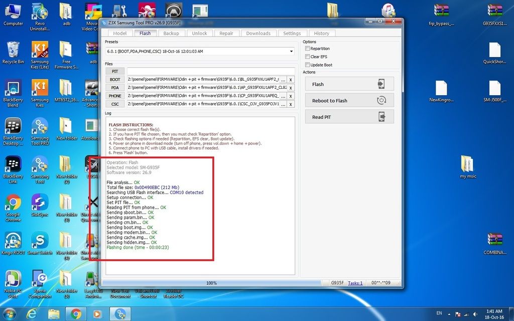

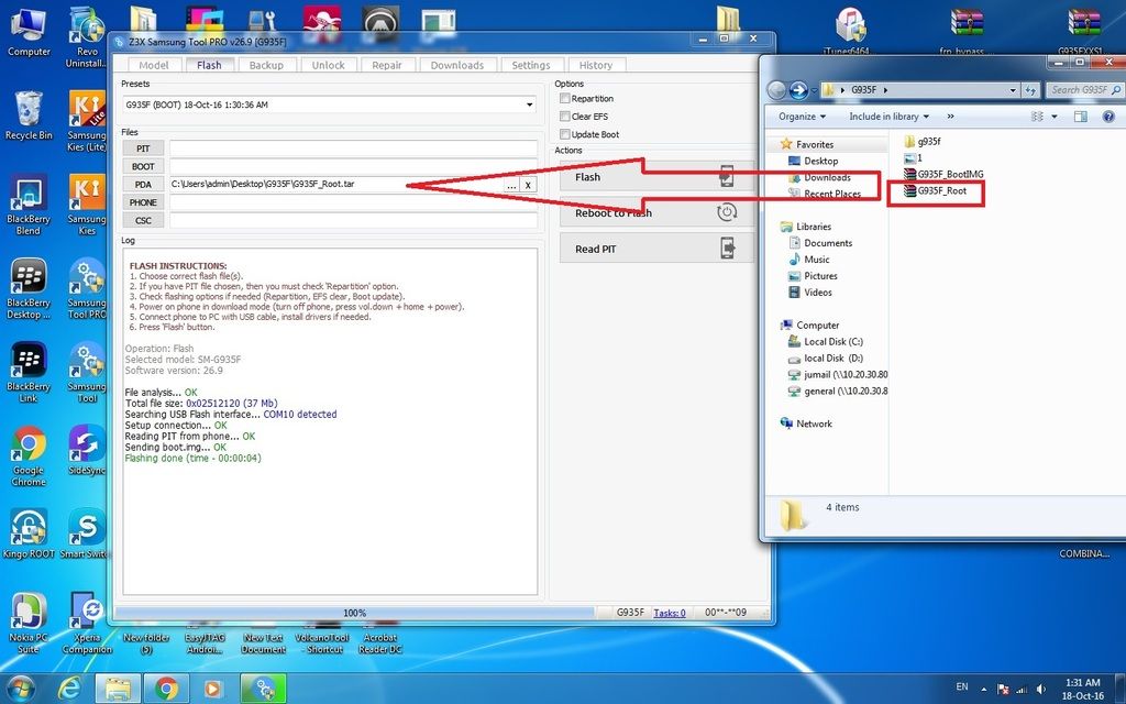

Flash boot tar
flash root

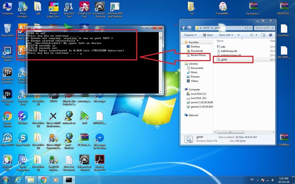

Run the Bat file to remove the FRP lock
after po niyan

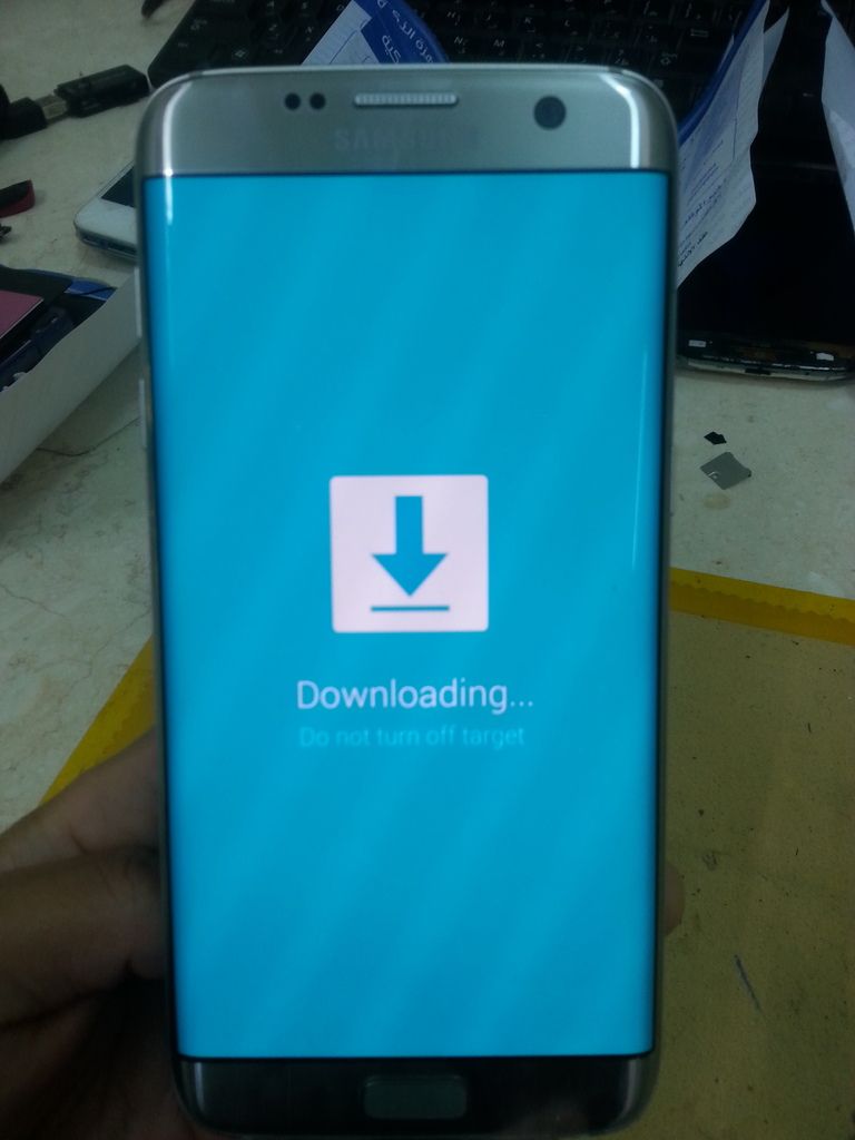

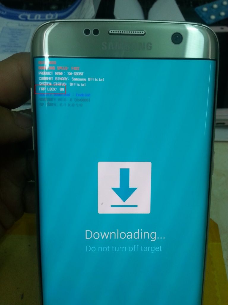

magrerestart ang unit to download mode
gaya po nito

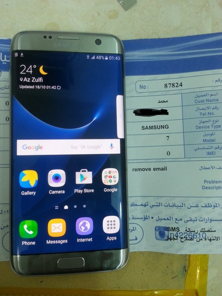

sabay software
check
done
sana po makatulong sa lahat
