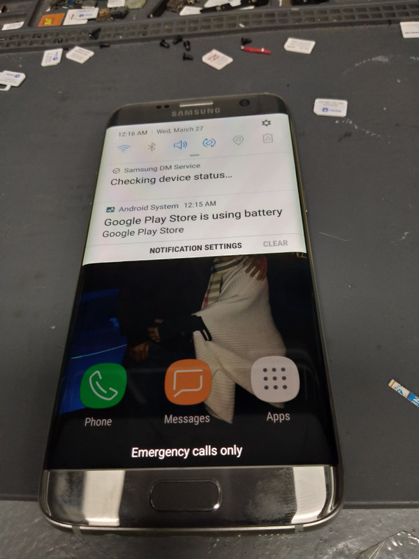

note
kapag emergency call lang cya after unlock need mo i unlock ulit...kaya dapat wag muna iclose yun octoplus icon or gui...
para di mag consume ng credit ulit..
sa akin kc ganyan nangyari...so need re unlock...
nearest amegy bank
ayan emergency lang cya...
so need re unlock

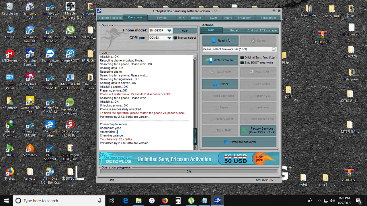

logs
Platform: Samsung Android
Selected port: COM63
Selected model: SM-G935P
Operation: Unlock
Attention: The Unlock process may take up to 10 minutes.
Searching for a phone. Please wait...
Detected phone model: SM-G935P
Firmware compiled date: Tue Oct 30 19:50:39 KST 2018
PDA version: G935PVPS8CRK1
CSC version: G935PSPT8CRK1
SW version: G935PVPS8CRK1
Phone SN: 00000000000
Android version: 8.0.0 (R16NW)
Sales code: SPR
Country: USA
HW platform: msm8996
HW Chip: MSM8996
HW Modem: MSM8996
Security patch level: 2018-11-01
Warranty Void: 0
SIM 1 status: ready
Codename: hero2qltespr
Connecting to modem port...
Found phone on COM63
Reading IMEI...OK
Connecting to server...OK
Checking smart card...OK
Username: yeno
Authorizing...OK
Checking balance...OK
Checking operation...OK
Your balance: 20 credits.
Sending device information...OK
Initializing exploit...OK
Preparing phone..OK
Phone will restart now. Please don't disconnect cable!
Initializing...OK
Unlocking phone...OK
Phone is successfully unlocked
To finish the operation, please restart the phone via phone's menu.
Performed by 2.7.8 Software version.

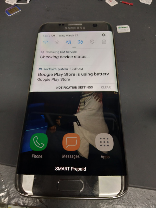

after that
heto na ang unit
