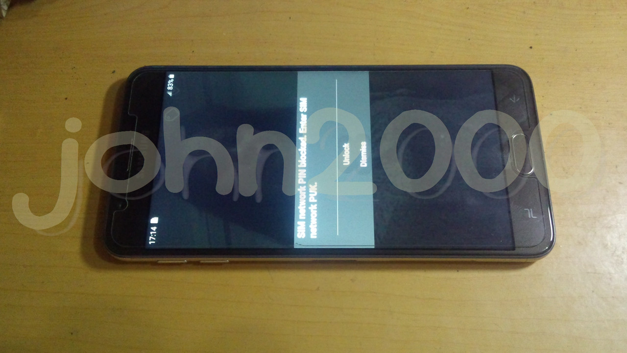

Samsung Galaxy J7 Prime 2 Network Lock
History :
Padala galing sa Saudi pero hindi magamit sa Smart at Globe
Solution :
Network Unlock by Read Code via Server

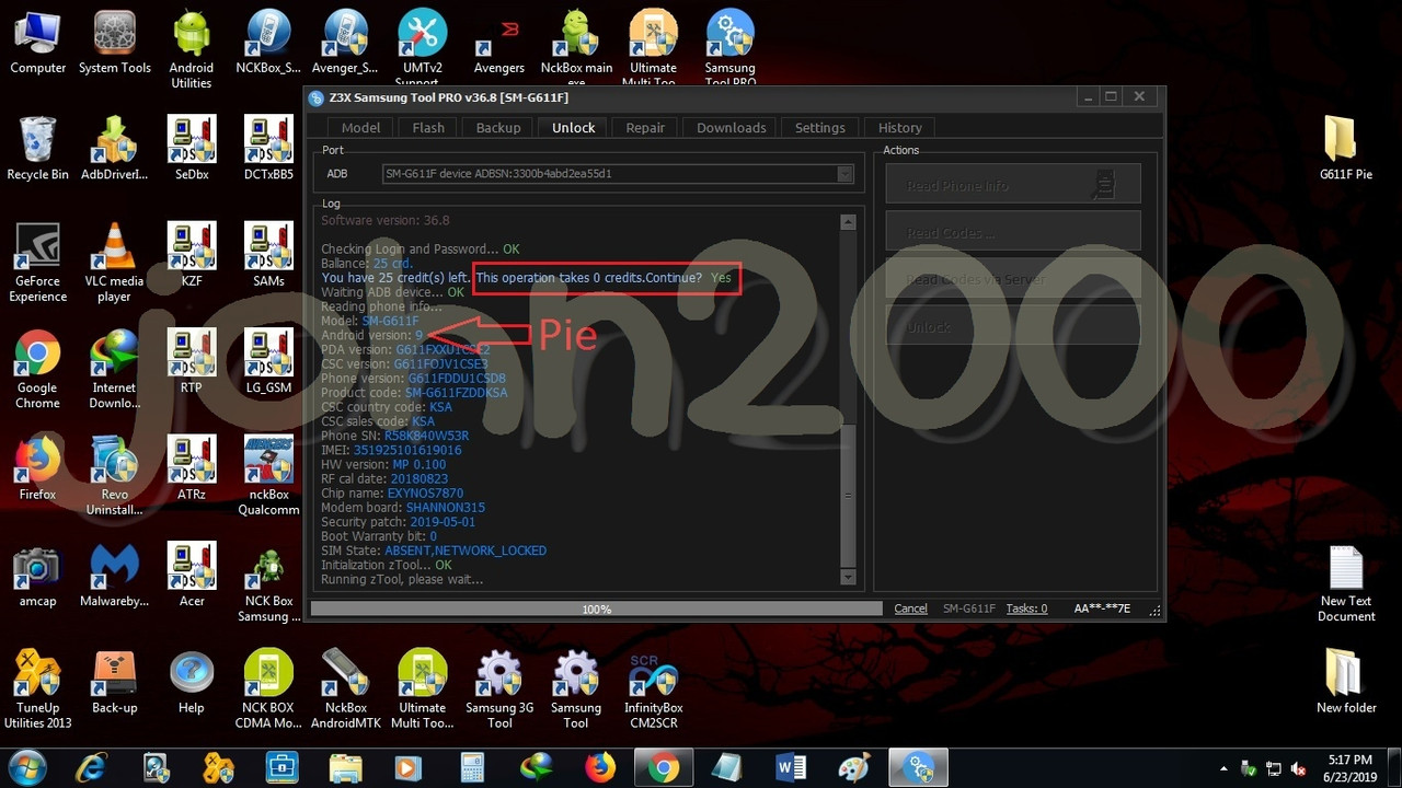

Read Mode muna bago i unlock,Kailangang i downgrade sa Android 7.1.1 at kailangang i Root pa.
May mga feedback na nag bluescreen at minsan nagloloko ang device or nag re restart.
Mas SAFE kung sa Read Code via Server kaya lang need na may credits kahit na Zero Credit ang pag unlock

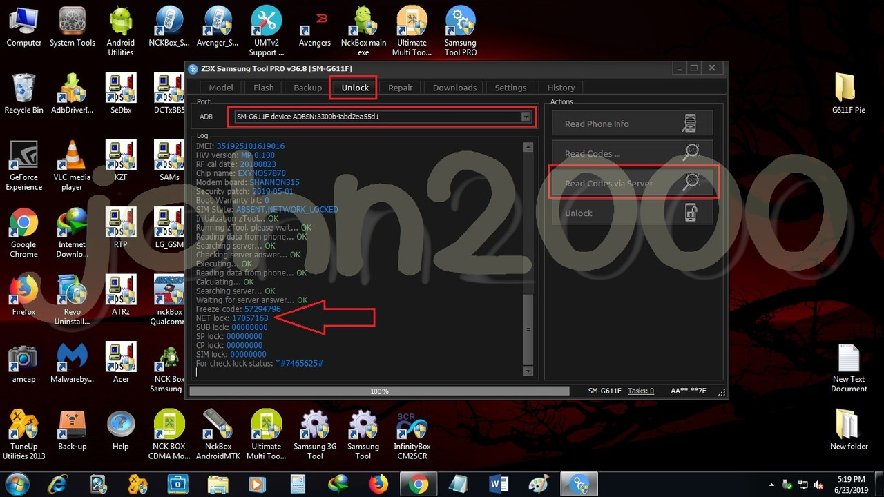

Run Samsung Tool PRO GUI
Select correct model in Model Tab
Click Unlock Tab
Insert CA-101 Micro USB Cable
Select Device connected in ADB Port
Click Read Code via Server Button
Confirmation to continue operation popup just hit Yes
Wait till all code appear
Enter NET Lock Code (Unlock Unsuccessful)
Enter Freeze Code and then NET Lock Code
Result :
Done..
