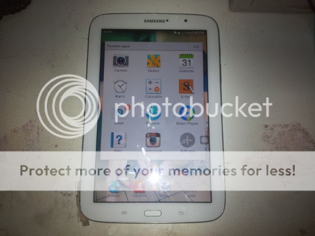

Galaxy nOte tab 8.0 i467 UnLOckED
Need:
* z3x samsung
* Micro uart cable
Procedure:
* go to calculator
* type ---> (+30012012732+ to view Factory Mode
* type ---> *#7284# select "Modem" under UART
* type ---> *#9090# select "DM over UART"
* select model i9505
* click Direct Unlock
* your dOne.....
Selected model: I9505
Selected port: COM55 Z3X BOX Serial Port
Selected port speed: 115200
Reading phone info...
Build: M9615ACEHWMAZD179660
Reading security... OK
Calculating... OK
Writing security... OK
Reseting...
Unlock done
Done with Samsung Tool v.16.0
