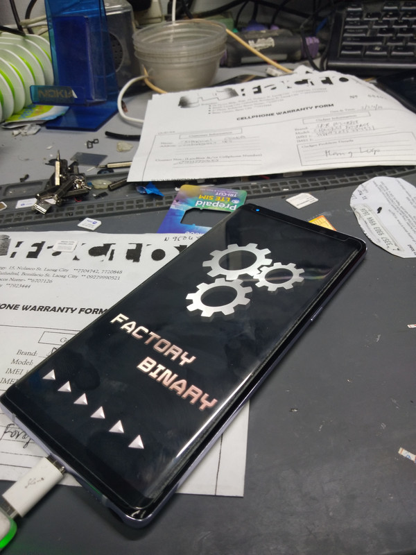

COMBINATION_FA71_N950USQU5ARJ1
yan file na yan ang idonwload sa z3x support for the combination file...and also stock rom from samobile...
wagna natin pahabain flash sa odin or z3x box yun combination file...
after flash hang yan so need to hard resset in recovery mode...
ganito sa hang
just press up and down , bixby at power para mag reboot at pag nagreboot bitawan yun vol down at power pero naka press parin ang up vol at bixby (sa baba yan ng vol down)
then mag proproceed sya sa recovery...just make wipe data then rrestart...

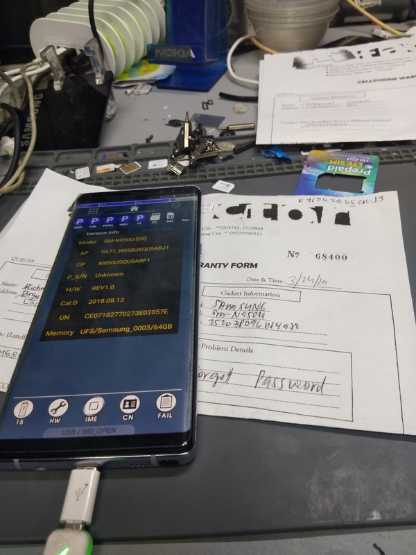

next step is
punta ka setting on debugger by tapping 7x build number
on oem
debugger then
punta dial naman this *#0808#
then select yun pinaka baba...
wag muna factory resset sa setting kc di uubra or gumamit ng frp tool software error lang yan ;))

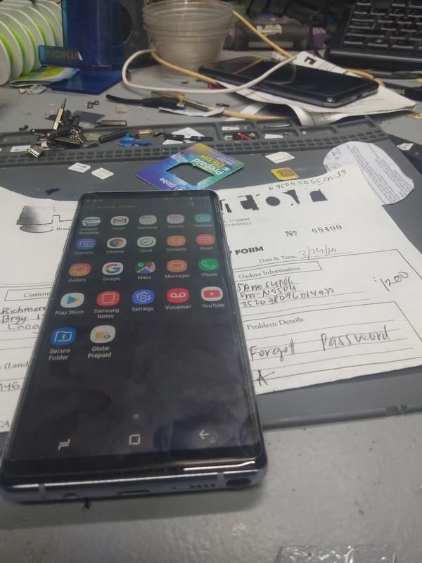

so proceed na tayu sa flashing stock rom...
oops panu matatangal yun frp kung di na resset???
eto ang tricks
sa picture na...
flash lang yan 3 file sa stock rom...
after flash
walay na frp smile na:D
finish na
finish product
