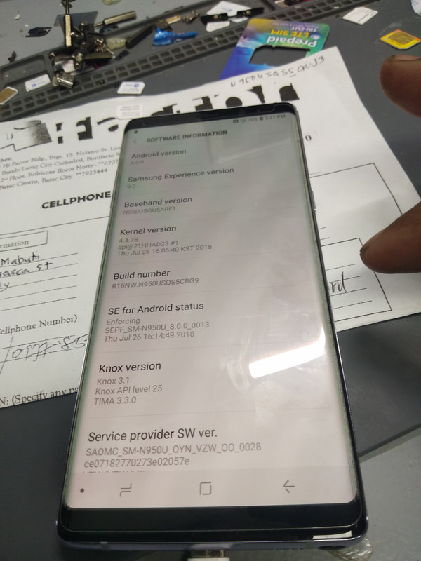

galaxy note8 n950u
problem;
frp/google account

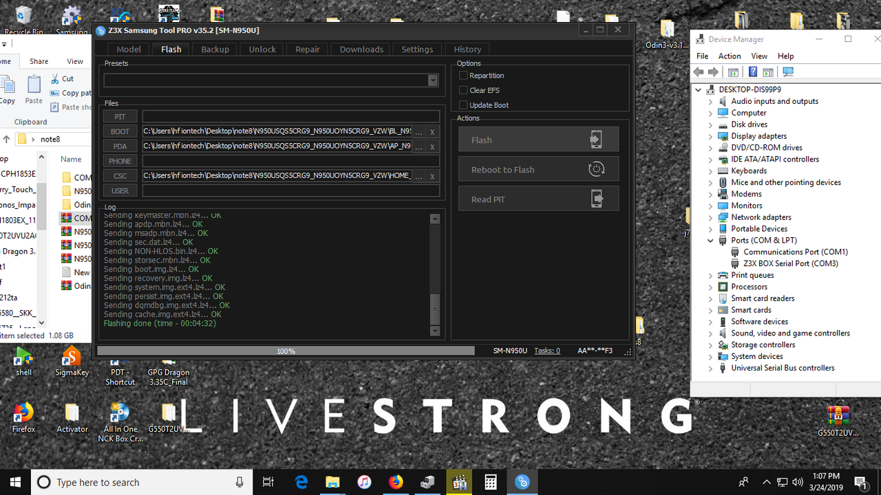

needed file download in
samobile and z3x support for the combination file...

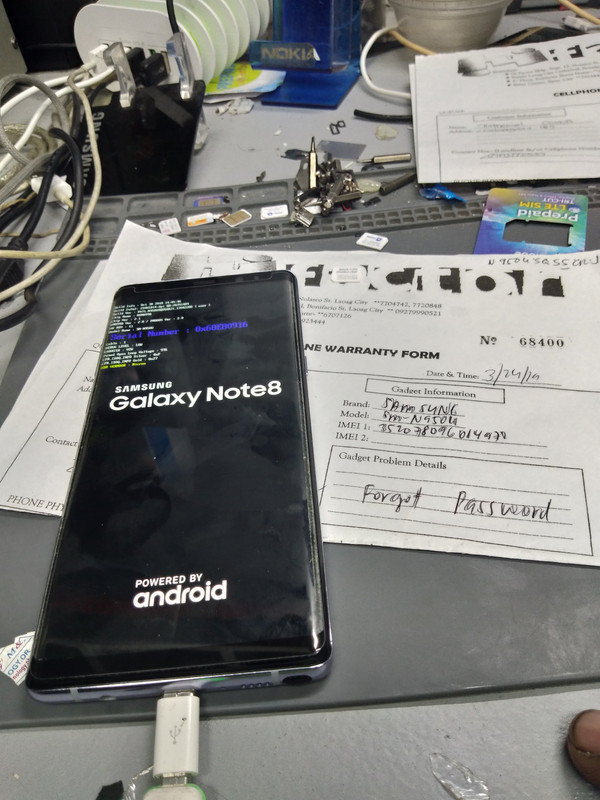

COMBINATION_FA71_N950USQU5ARJ1
yan file na yan ang idonwload sa z3x support for the combination file...and also stock rom from samobile...
wagna natin pahabain flash sa odin or z3x box yun combination file...
after flash hang yan so need to hard resset in recovery mode...
ganito sa hang
just press up and down , bixby at power para mag reboot at pag nagreboot bitawan yun vol down at power pero naka press parin ang up vol at bixby (sa baba yan ng vol down)
then mag proproceed sya sa recovery...just make wipe data then rrestart...

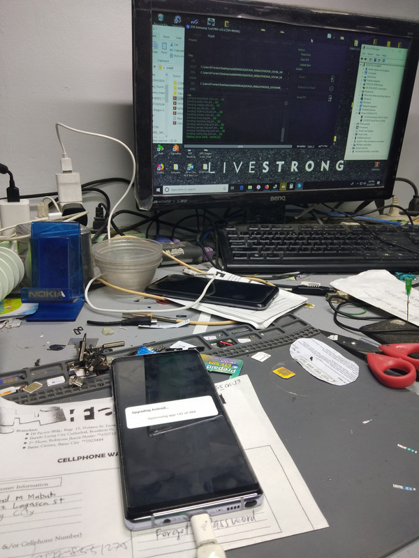

flash lang yan 3 file sa stock rom...
after flash
walay na frp smile na:D
finish na
