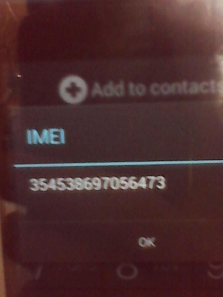

GT-I8190 AFTER FLASH INVALID IMEI
MTK6571 YUNG CHIPSET NYA

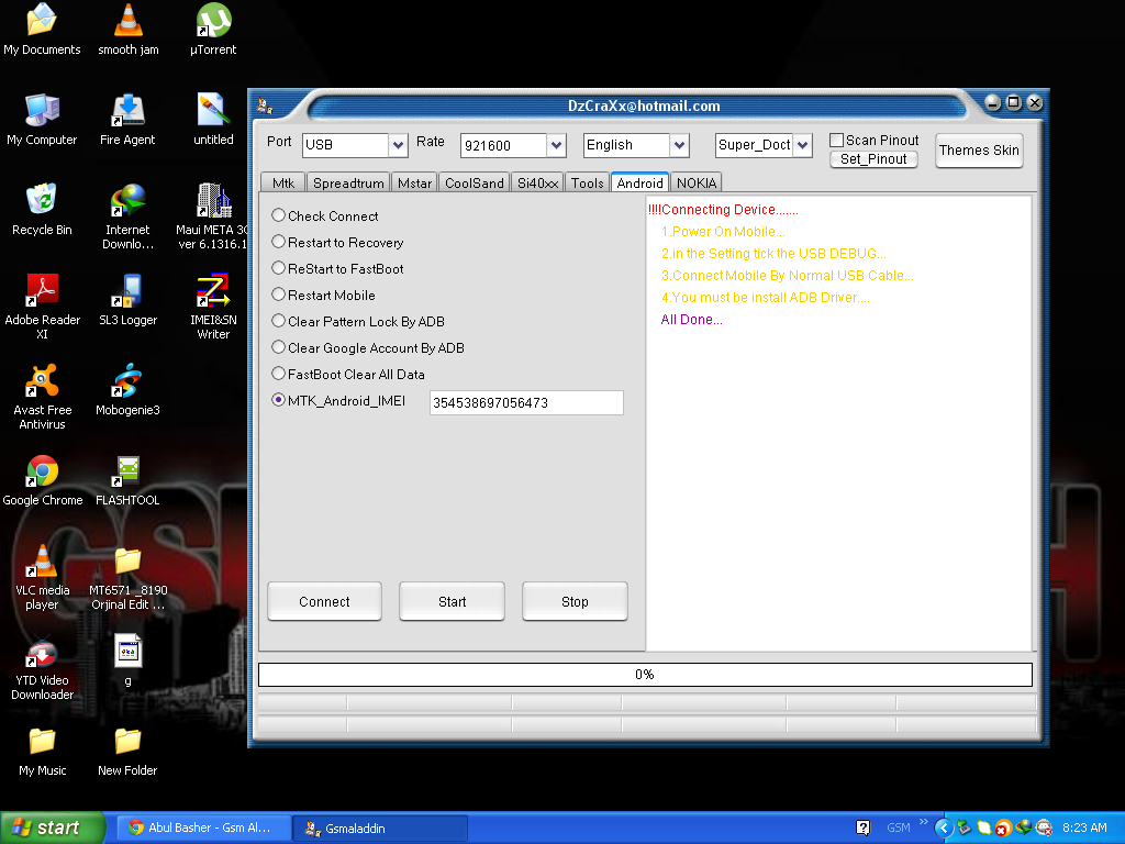

PROCEDURE: 1.Phone must be rooted
2.turn on your phone then enable USBDEBUGGING
3.OPEN tool....port must set to USB http://www.mediafire.com/download/dw1d6151pbei523/GSMALADDIN+Setup+1.18.exe
4.UNCHECk scan pinoout
5.Select ANDROID ABOVE
6Tick MTK_ANDROID _IMEI
7.TYPE the 15 digits imei
8.MOST important of all.........
KUNIN MO NA ANG BAYAD NI TUMER
)....100%TESTED BY ME
