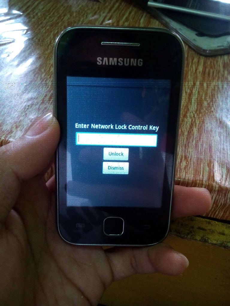

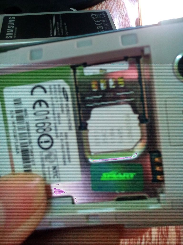

try ko cya lagyan ng tm sim
ito cya naghahanap ng code

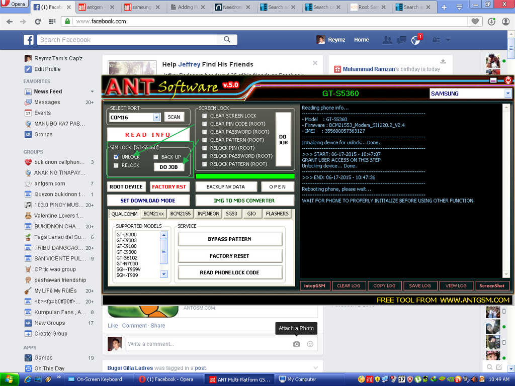

open ant soft v5 sundan nyo lng image ko
check unlock
and click do job

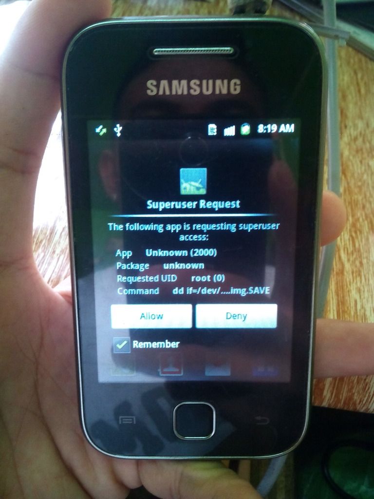

kailangan din nka unlock lagi ang screen ng phone dahil
habang ngpaproces ang antsoft lalabas super user (NOTE) lalabas lng yan kpg rooted na cp nyo so root muna bago unlock :)
click allow lng tapos mg rebot hngtayin lng fully backmenuang phone tsaka off at lgyan na ng tm sim/globe oh kht anung sim :)
