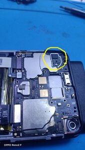

mga lods, anu kayang problema..
-kapag naka charge, unli reboot lang
-kapag hindi nakacharge tapos in'on nag vibrate lang
-di ma access recovery, fastboot oo
--na try ko na ireprogram,linis then reheat, wala pa rin
anu pa kaya pwedeng gawin? maraming salamat.
