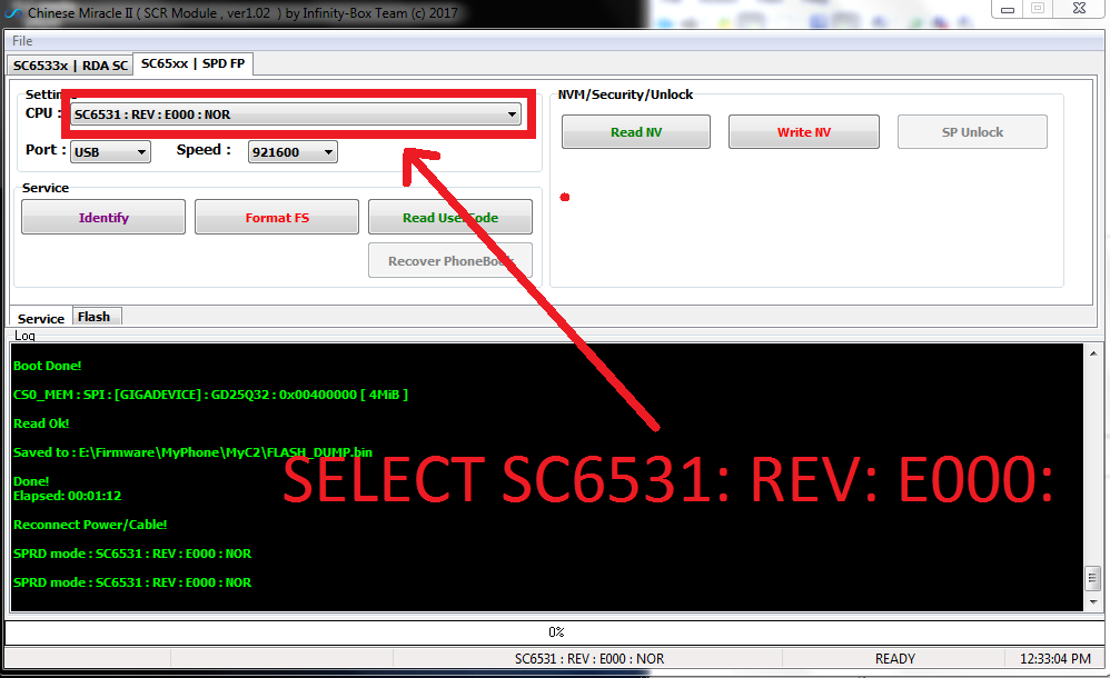

I ishanicole Registered Joined Jun 5, 2018 Messages 23 Reaction score 0 Points 1 Location calinan davao city, davao del sur PHILIPPINES Feb 4, 2019 #1 SHARE KO LANG PO ITO MYPHONE MYC2 [/url][/IMG] PROBLEM .... PASSWORD SPD PO SYA AT # ANG BOOT KEY PERO AYAW NYA MAG FORMAT...UP KO LANG KUNG SINO MAY IDEA NITO....

SONNY Registered Joined Nov 27, 2014 Messages 2,996 Reaction score 69 Points 381 Location Butuan City Aug 28, 2020 #3 Use CM2 SCR Select SC6531 : REV : E000 : NOR Boot Key: #
