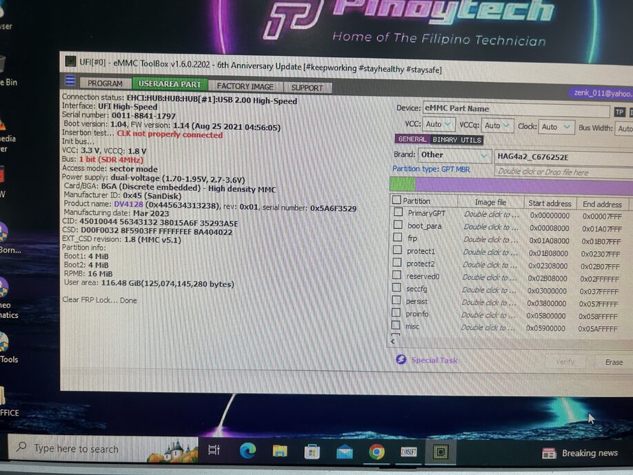

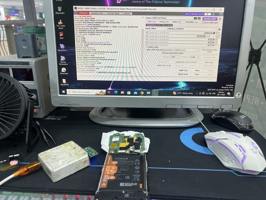

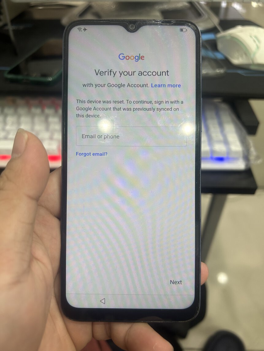

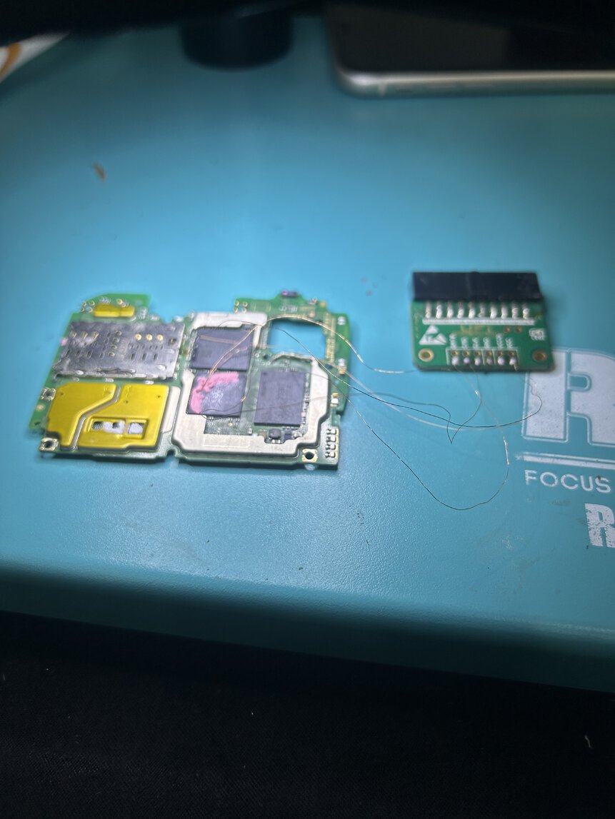

Good Day mga idol!
Share ko lang Honor X6 FRP Problem.
Natey na ni customer sa youtube pero waal umubra.
Solution and Screenshots:
1. Use isp pinout
dito ko kinuha ang pinout sa post ni sir stynx
https://pinoytechnician.com/threads/honor-x6-vne-lx2-frp-done-isp-work.235684/

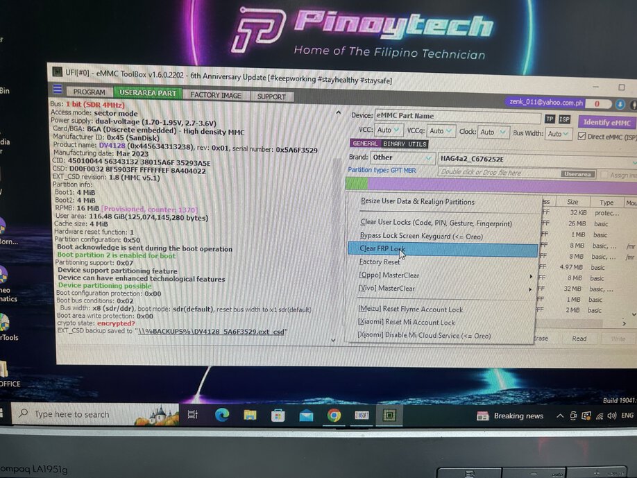

2. Open UFI- eMMC ToolBox
3. Put check on direct emmc (isp) then tick Identify emmc
4. Go to USERAREA PART tab
5. Tick Special Task

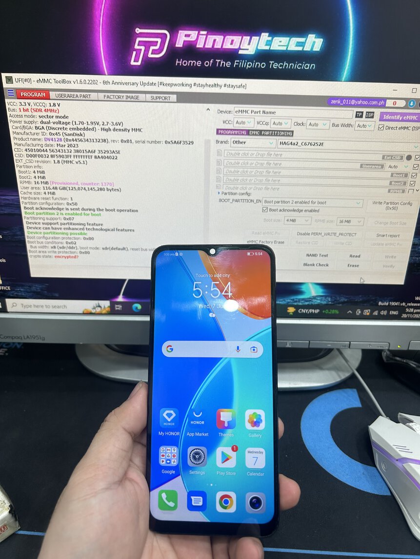

6. Choose Clear FRP lock and wait till done.

Thanks for viewing!
