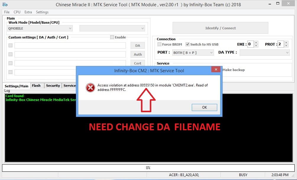

DA filenames like:Qmobile CS1 Security 2018 by Kirumira.bin etc... Will not work at all,YOU WILL GET THIS ERROR BELOW
YOU HAVE TO CHANGE DA FILENAME LIKE:-
* DA_SWSEC.bin
* MTK_AllInOne_DA_SP.bin
* DA_PL.bin
* DA_PL_CRYPTO20.bin
* MTK_AllInOne_DA.bin
