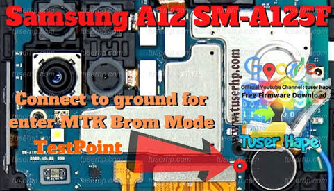

paki sundan na lng ang video completo na yan salamat poh
1.open hydra mtk tool
2.select brand samsung
3.model sm-a125f <a12>
4.open mo yung likod at do the tp
5.open mo rin yung device meneger para makita mo kng nadetech na ang cp mo
6.kpag nakita na yung cp mo click boot info
7.my lalabas jan na confirm yes nio lng
8.hintayin nio matapos and click pm
9. click partion
10. hanapin nio lng yung persistent at click nio yung box at click erase at wait nio matapos
