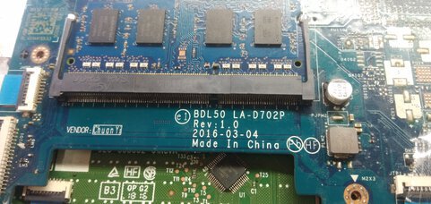

Model: Hp 15-AY series
Board id ; BDL50 LA-D702P
IssueN : NO WERPA (shortedboard)

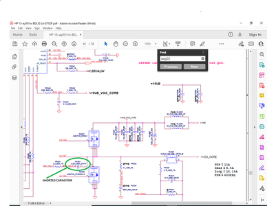

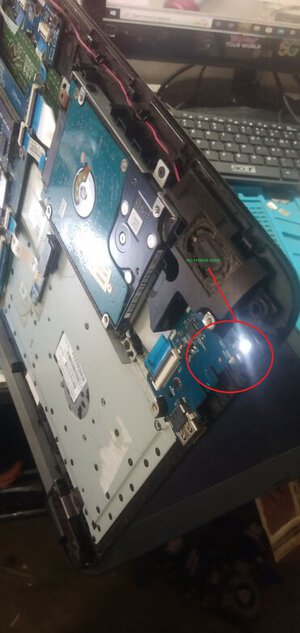

1. Check charging pin at charger working
2. Nxt open then unit diagnose and view circuitboard kng my cruded part wala naman

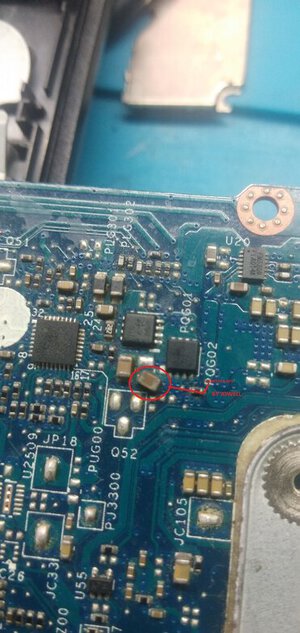

3. Check 19v rail missing ibang line papuntang mainreg....
4. Nxt diodetest mode tayo check all coil kng ang my lake or shorted part
5. Un via diode test kita shorted caps in +vcg core line see in picture
DONE.....
