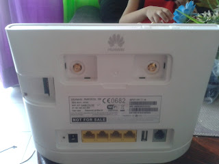

Unlocking will be done on USB mode (GREEN LED) for the first time unit going to USB Mode is easy... the 2nd time a round have some little difficulties.
On the USB Mode you need USB cable Male to Male (nabili ko sakin 200 pesos USB 3.0) dahil alam ko kuripot ka.. gawa ka nalang!
Putulin mo yung USB charger na Sira i dugtong mo Male to Male pag pares pares mo yung kulay ng cable.
Uhm hindi sakin unit eto .. hahaha sandali kolang nagalaw.[/FONT]

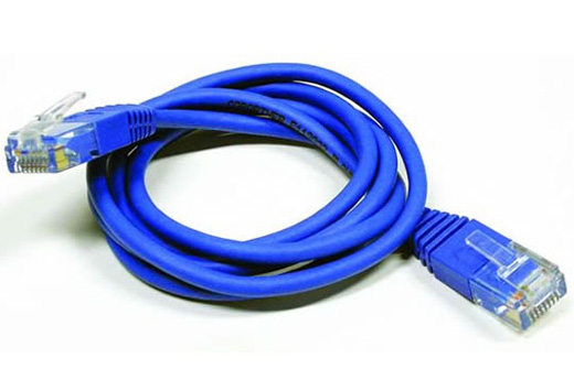

Kailangan mo din ng L[FONT=&quot]AN cable ( [FONT=&quot]in case[/FONT] na super newbie ka mag unlock nito )[/FONT][/FONT]

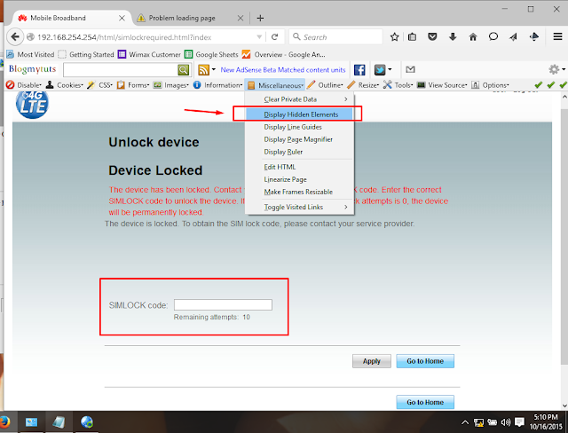

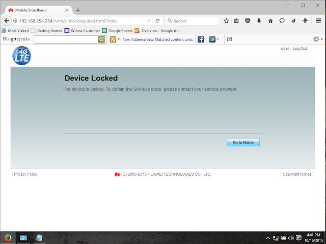

I inserted SMART LTE Sim as you can see Device is Locked..

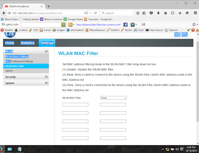

You can block any client here with their MAC

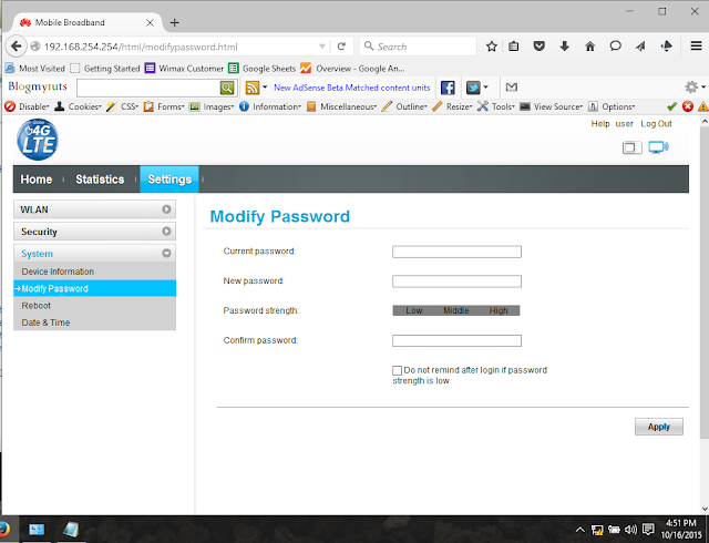

[FONT=&quot]You can also Change the default user password here.[/FONT]
You can access http://192.168.254.254/html/simlockrequired.html you can insert Unlocked Code or New ALGO (but this is useless)

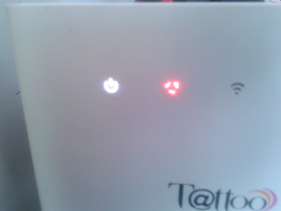

RED LED Lights
3. When RED LED is out Release WPS + Power and wait for Color Blue LED light.

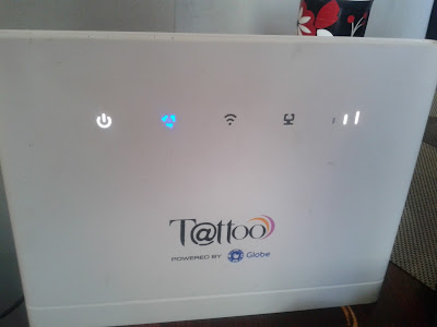

7. It will turn Blue again then wait a few second sipol sipol ka muna.. mag GREEN LED stay Stable..
Your USB Mode is Ready!!.

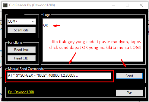

3. Unlocked by Cid Reader by DAWOOD128 ( original post tootsie) or Huawei Cid Reader (GSM Forum) download mo cge para wala na tanong tanong ng link eh meron naman kasi sa net nyan.. huwag tamad mag comment ng thanks and hit like or feedback after neto............[/FONT]
[FONT=&quot] pass: [FONT=&quot]antgsm[/FONT][/FONT]​
[FONT=&quot]
[/FONT][FONT=&quot]
[/FONT] [FONT=&quot]a) Put the right COM port (you can find that on device manager) : sample here Com7.[/FONT]
[FONT=&quot]b) Read Imei (for testing purposes )[/FONT]

[/FONT] [FONT=&quot]c) Input this three code copy paste on Manual send command[/FONT]
[FONT=&quot]
First -Unang code: [/FONT]
[FONT=&quot]at ^ nvwrex = 8268,0,12,1,0,0,0,2,0,0,0, a, 0,0,0[/FONT]
[FONT=&quot]
[/FONT] [FONT=&quot]after sending command you will receive OK delete the OK
Second Pangalawang code:
AT ^ SYSCFGEX = "00", 3FFFFFFF, 1,2,800C5 ,,[/FONT]
[FONT=&quot]
[/FONT] [FONT=&quot]after sending command you will receive OK delete the OK[/FONT]
[FONT=&quot]
Third Pangatlong code:
AT ^ SYSCFGEX = "0302", 400000,1,2,800C5 ,,[/FONT]
[FONT=&quot]
[/FONT]
[FONT=&quot]after sending command you will receive OK[/FONT]
[FONT=&quot]Kaya ko pina delete yung OK para sure OK yung natangap mo reply kapag 3 OK na unlocked na yan modem mo...[/FONT]

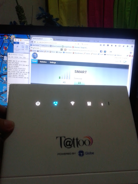

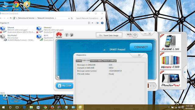

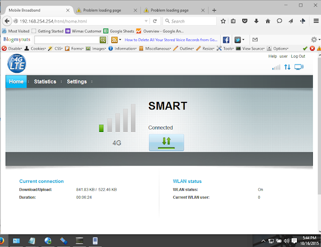

[/FONT] [FONT=&quot]Check Your Modem is Unlocked Insert Smart Sim.. Plug power cable then unplug again.. Check if it can read the Sim.[/FONT]
[FONT=&quot]

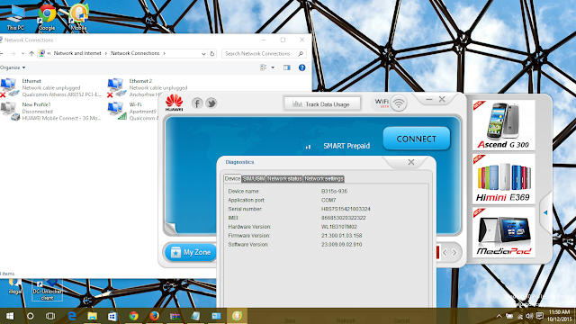

[/FONT] [FONT=&quot]Checking via Mobile Partner on USB Mode.[/FONT]

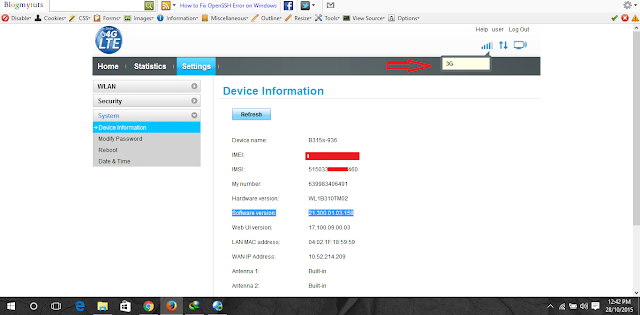

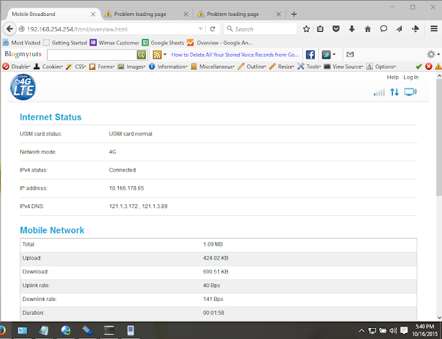

[/FONT] [FONT=&quot]Unlocked Check by Browser ..[/FONT]
[FONT=&quot]
[/FONT]
[FONT=&quot]
[/FONT] [FONT=&quot]SKY BLUE LED LIGHT 4G connection[/FONT]
[FONT=&quot]
3G Mode Regular Smart Sim[/B][/FONT]
[FONT=&quot]NOTE: Sa mga nag tatanong bakit 3G lang signal ng modem nila.. Dipende sa Area yan kung available ang 4G or malakas ang 4G at Dapat siyempre LTE Sim ang gagamitin Yung sa tuts ko LTE Sim ng Smart (Prepaid) na agad gamit at agad naman nag connect dahil LTE na ang City dito sa amin. Sa Mobile Partner yung sakin naka set ng Auto.. Tested na na yan pag 3G lang available 3G lang yung modem na try na yan sa ibang Area ng nag pa unlocked.[/FONT]
[FONT=&quot]Kung gusto nyo naka lock sa 4G yan signal yung third code "0302" gawin "03" , bad news pag 3G lang connection nyo RED yan no signal. (pwede din wps+power need lang timing pag nag red na release muna)[/FONT]
[FONT=&quot]
[/FONT]
[FONT=&quot][/FONT]​
[FONT=&quot]
[FONT=&quot]
[FONT=&quot]
[FONT=&quot]
[FONT=&quot]
[FONT=&quot]
[/FONT]
[FONT=&quot]
[FONT=&quot]
[/FONT]
[FONT=&quot]
[FONT=&quot]
